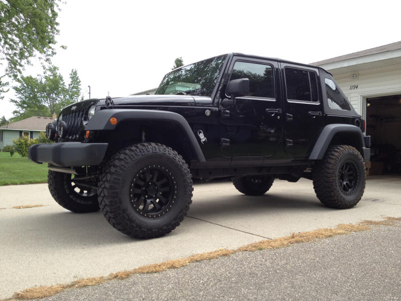

So I have a 2013 JKUS and have been reading and reading on here. At first I was going to do a small lift with 35's but the more I read I know I'm gonna want 37's. It will be a weekend driver and play in the mud for the most part, so not much crawling. What 3.5" or 4" lift does everyone recommend? And will the lift come with everything i need? I don't mind spending more for a good lift, but don't want to go crazy on the lift if I don't need to. Also, what else is a must to run 37's. I have 3:73's right now. Any input would be greatly appreciated.
I run the BDS 4.5" lift, and stock driveshafts. I have wheeled it and have had no need for a front or rear driveshaft replacement.

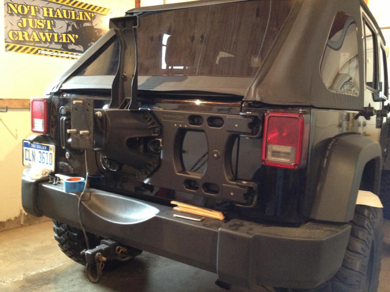

Here is the latest install - a teraflex HD hinge.
<img src="https://www.jk-forum.com/forums/attachment.php?attachmentid=406233"/>
<img src="https://www.jk-forum.com/forums/attachment.php?attachmentid=406234"/>
Looks good
