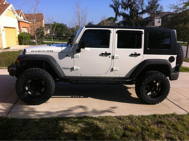

Running 35's with A/T
Attachment 497096
I would try to find someone around your location that has gears in theirs and see if you could ride with them.
I have let folks drive my jeep with 5:38's and gears and they usually end up regearing to match there tire size.
As far as more power than that I am thinking a turbo would be better suited to my needs.
With 5:38's and a rubi case I feel like I have plenty of torque when crawling.
Riding down the interstate hitting hills is where it feels like a slug.
