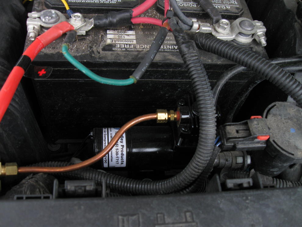

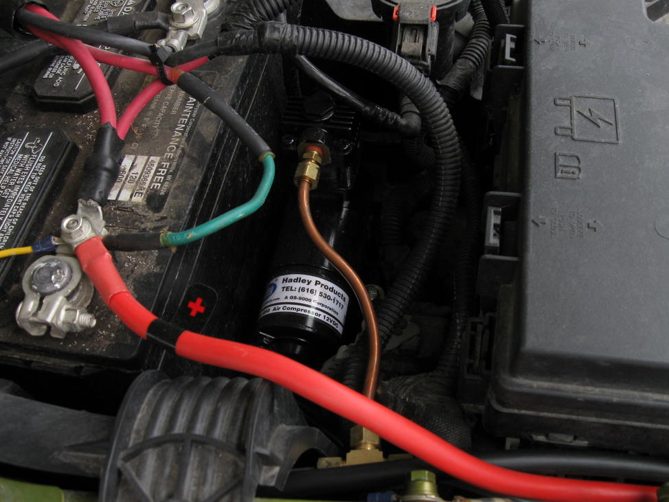

I have mine mounted in front of the battery. It is a small compresser but it will fill 150 psi in 4 min

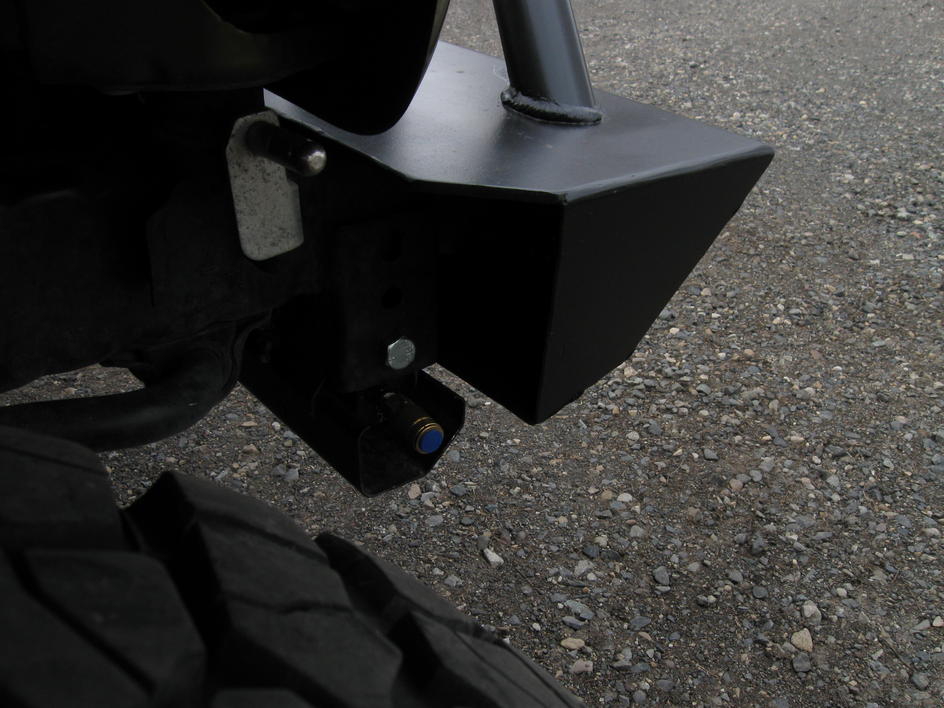

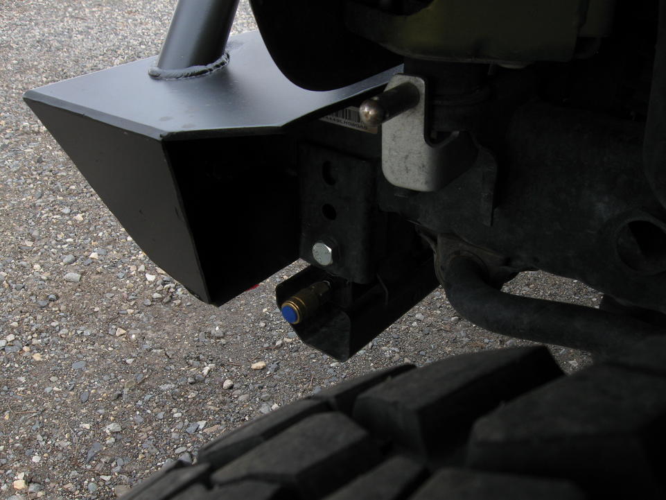

This is where I have it stubbed out at one on each side

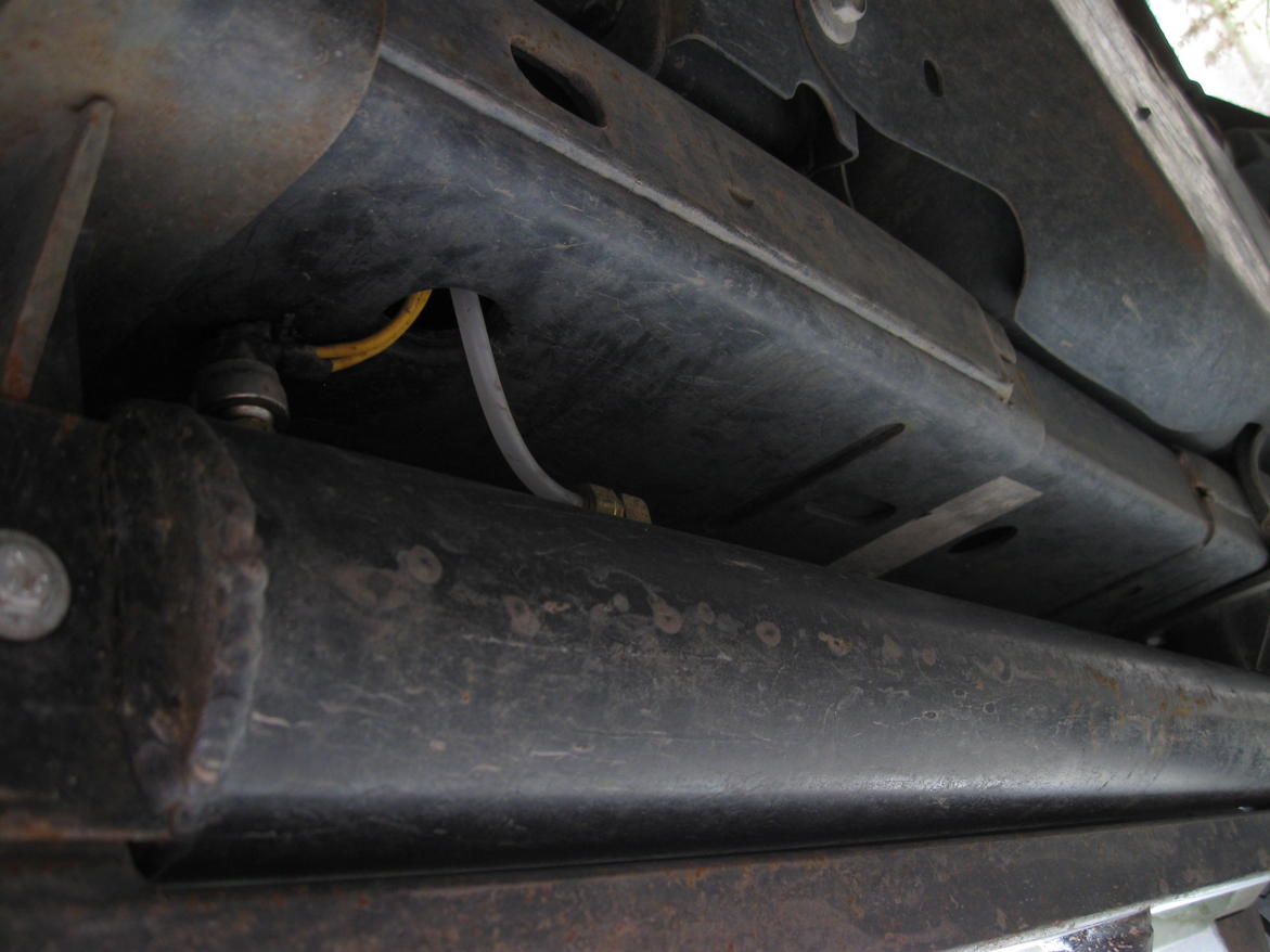

And this is the tank I built to fit between my slider and the frame.I hope it helps
