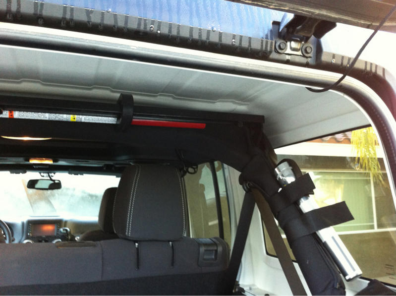

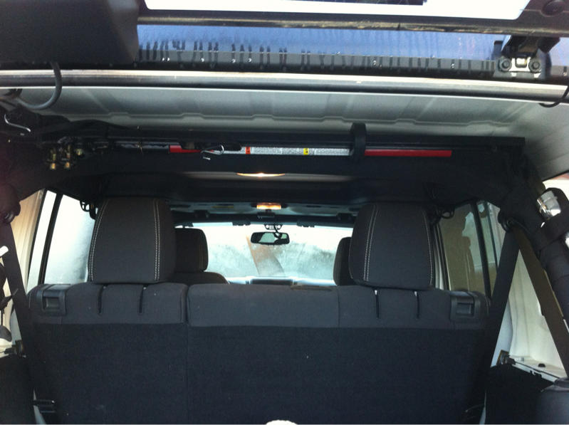

Here us the pic of my jack mount.

Old Dec 28, 2012 | 06:39 AM
Maniacal's Avatar
Posts: 194
From: Abilene
Looks out of the way and still accessible! See that's what I Envisioned. Thanks for the pics.
It makes for a very clean install.

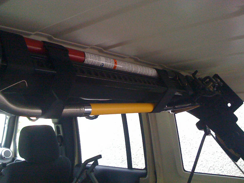

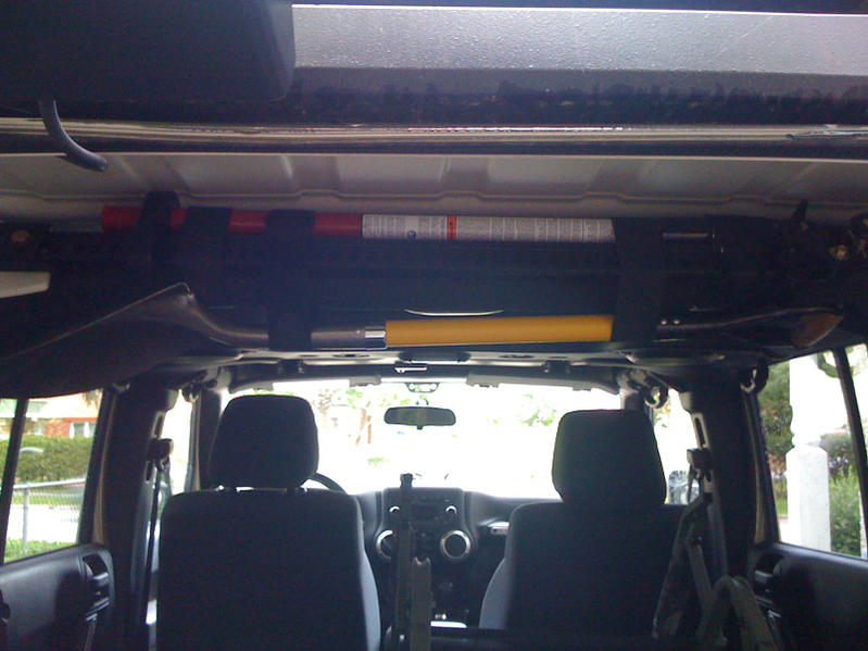

If you look up HI-Lift mount options on the forum here is my input of that thread:
I secured my hi-lift and shovel with 4 heavy duty velco straps from Home Depot. Doesn't budge at all... only thing different this year is I added some foam squares where the plate and screw (from Hi-lift) makes contact with the fabric. Last year it cut through the fabric at those spots (no big deal). Live and learn.

Old Dec 28, 2012 | 08:05 AM
Tanner6427's Avatar
Posts: 437
From: Las Vegas, NV
Awesome idea!! Thanks
