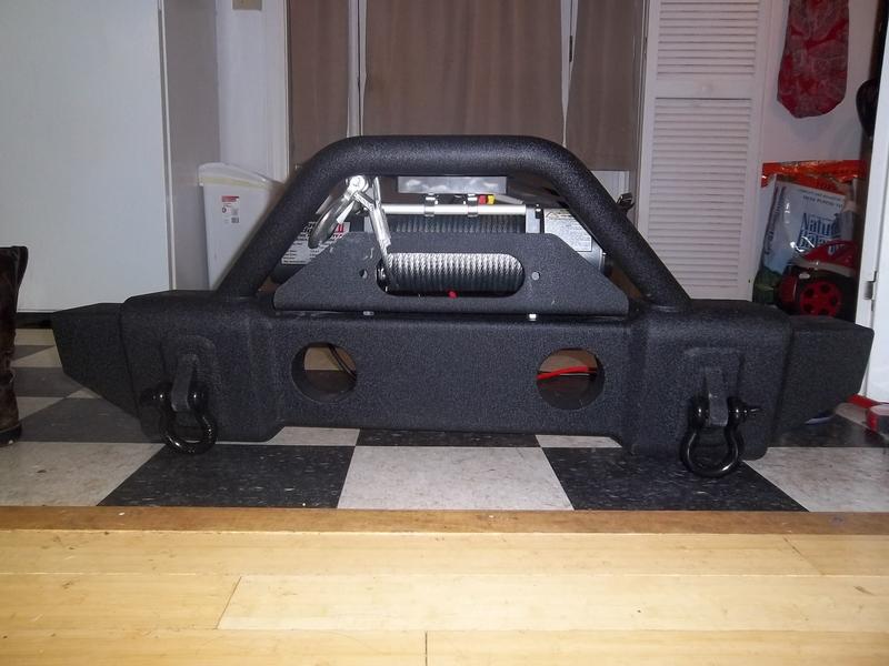

I have a shorty rampage bumper and a 8500 rugged ridge winch. I bolted the winch to the winch plate that came with the bumper. Now I'm trying to bolt the winch plate to the bumper but the heads of the bolts holding the winch on are causing a gap between the winch plate and bumper. Should i drill 4 more holes in the top of the bumper and have the bolts holding the winch on go through the bumper and winch plate or just leave it the way it is sitting on top of the bumper. sorry this is confusing as hell so ive posted a few pictures of what im working with...

If it were me, I would remove the winch...bolt down the winch plate...drill the winch mounting holes through the bumper...bolt the winch throught the bumper and mounting plate...that way you have the winch and plate bolted with 8 bolts, nice and flush.
Only snag I see is I'm not sure how long the winch bolts are...if they are long enough to go through both...

thats what i was thinking also but just wondering if there was a reason they did something like that...this is my first jeep/project minus the kc lights and im not really trying to mess it up already haha
I have the Rampage recovery bumper and a rugged ridge winch and ran into the same issue. All I did was get fender washers and used them as shims between the plate and the bumper. I used 3 or 4 on each plate mounting bolt (about the same thickness as the bolt heads) so the plate rested on the winches mounting bolts heads and didn't flex when torquing down the mounting bolts. I wouldn't drill and try to bolt through the bumper and the plate. It was hard enough mounting the winch on with the plate attached, I can imagine what a pain it would be that way.

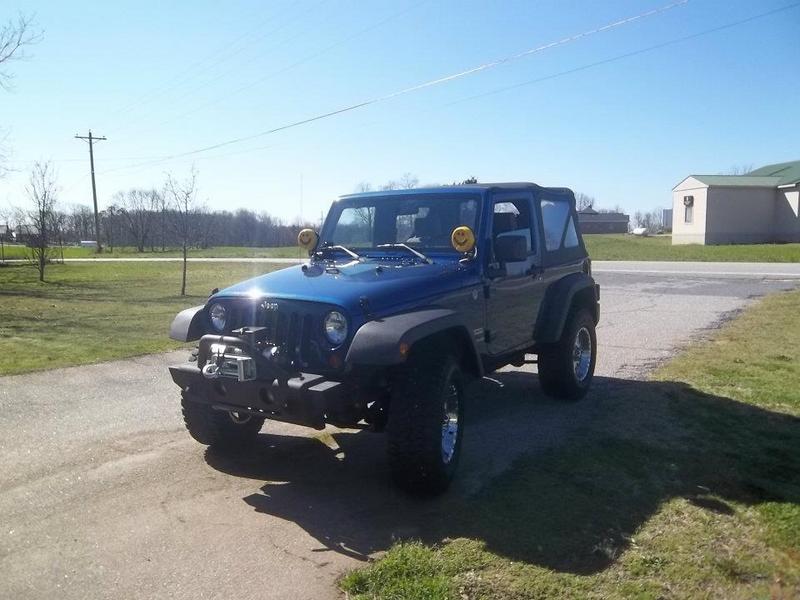

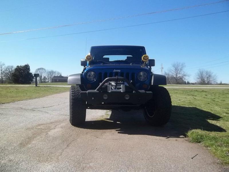

i talked to the local shop and thats what they suggested as well. yea dude i cant imagine trying to drill that thing now that would have been a real nightmare. in the end im very pleased with the comboAttachment 285492Attachment 285493
It was recommended to me that I get some steel plate to shim up the winch plate, which seems like a safer bet to me.
