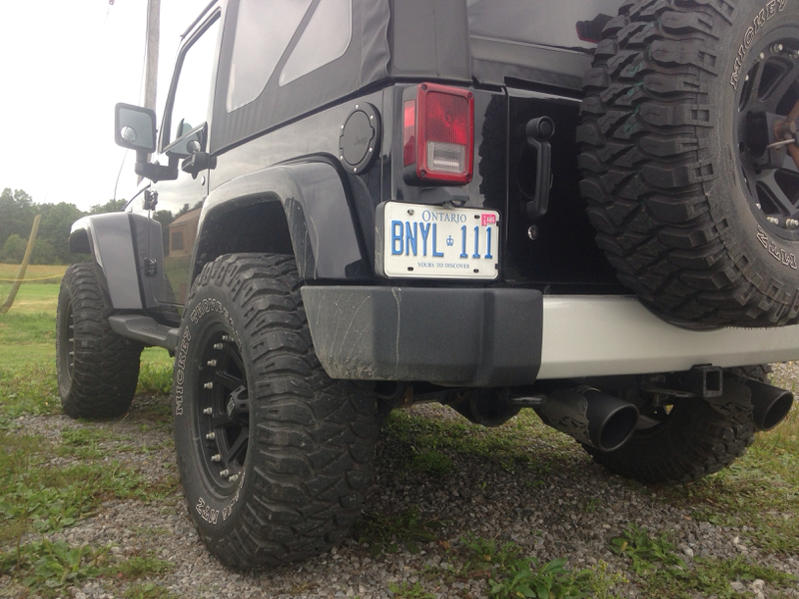

I have a 2012 2 door auto with the 3.5 lift and 37s. Due to the cost of the regear I decided to get the chip. With the chip you notice a large difference In your RPM. I can still feel the gears changing late but that's because I'm auto. If you want to run the stock gears in manual you should be fine. But i strongly recommend the chip!!

I have a 2012 2 door auto with the 3.5 lift and 37s. Due to the cost of the regear I decided to get the chip. With the chip you notice a large difference In your RPM. I can still feel the gears changing late but that's because I'm auto. If you want to run the stock gears in manual you should be fine. But i strongly recommend the chip!! <img src="https://www.jk-forum.com/forums/attachment.php?attachmentid=501219"/>
What chip did you get?
Superchip Flash Cal. Very easy to use. And very cost efficient compared to a re-gear
http://m.4wd.com/newui/search.aspx?sku=SCI3570
