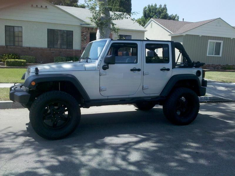

the above pic is pretty much what i started out with...a 2007 light grey stone two wheel drive unlimited x with just basic crank windows ac and cruise control with aprox 29,000 miles.it came fully mall rated with a cheap 4 inch zone lift on 35 inch toyo all terrains and 20 inch flat black raceline wheels...i was torn between this one and a white one that had a little less miles but i really wanted the crank windows and the light grey stone color is still my favorite color to date..

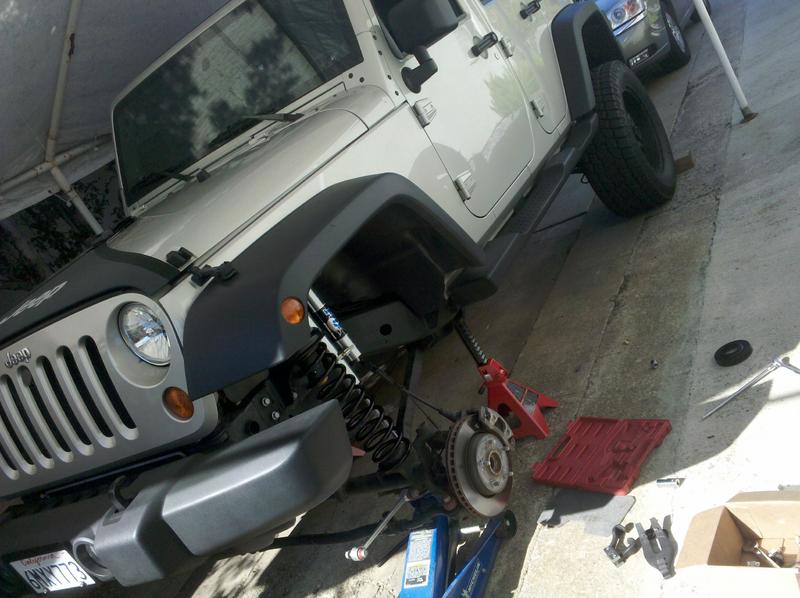

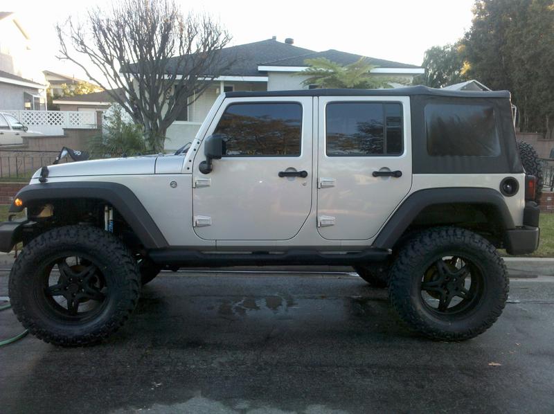

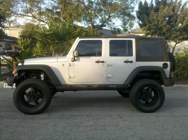

ID:	385246 the first order of business was the suspension..the goal was the ability to get about as much flex as a coil over keep the cg as low as possible and have a well balanced throw both in up and down travel..to do this i replaced the zone coils with a set of evos,i used a 1 inch body lift for clearance and as luck would have it i already had a set of rear fox 14 inch travel bypass shocks from my truck,all i had to do was machine a set of upper mounts and re valve them for my jk..i also had a set of 37 inch nitto trail grapplers in mall rated 20 inch for my truck that i was able to throw on to get the suspension primarily dialed in,these would not be staying on but worked well for building the suspension...i bought a set of matching shocks for the front and fabricated the bump stops..i didn't go to crazy with tuning it as i was in the process of building my axles and the driveshafts control arms track bars transfer case etc were all on there way...articulation would also be increased by using johnny joints for all the control arm bushings and axle mounting points,i always planned to keep the stock fenders as i had already seen the carnage aftermarket ones had done to the body of other rigs and with just minor trimming and precise tuning of my bump stops this was able to be done with little adverse effect clearance wise...

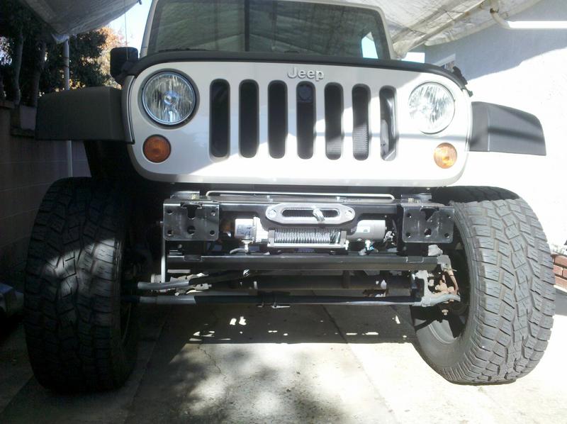

Old Nov 4, 2012 | 06:52 AM
nvertflyer's Avatar
Posts: 357
From: torrance ca
ID:	385258 in the process of fabricating my front bumper...winch is a warn m9000 on a custom built winch plate...i wanted it between the framerails to reduce leverage during a pull...by running it inverted i am able to keep it concealed....it has been worked hard in the last couple of yesrs and has never let me or anyone else down yet...note the 2wd axle tube and lack of a diff....it wouldnt stay this way for very long
