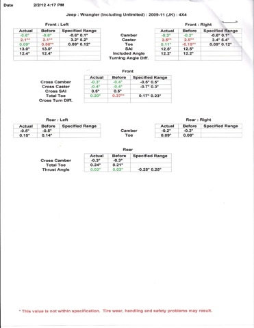

Originally Posted by UAE455
I did a wheel and steering alignment yesterday, but still goes left.....and got a serious leak from the left axle today...AEV 3.5" lift running 35" tires
Did you have a shop do this, or did you do it yourself? If it was done by a shop, (if you have it) can you post or take a pic of spec sheet so we can see the #'s...

Without adjustable LCAs an alignment is a waste after a lift. A shopping list won't solve the problem if you/the shop doesn't understand what the problems are.

This is sheet I got yesterday...

Also... Did you put a gas charged steering stabilizer on? If so, they are known (ESP. Bilstein) to cause left pull. If not, like others have said, you most likely need axle adjust and alignment.
