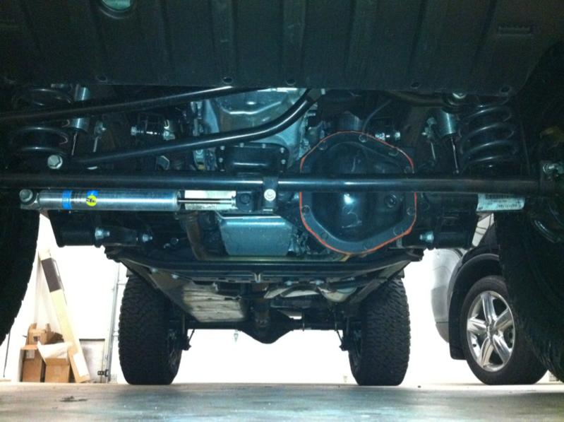

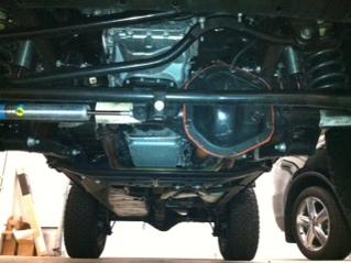

Your caster is 2.1. Stock our vehicles have roughly 4.5. That's why it feels sloppy on the road.
Old Feb 3, 2012 | 04:42 PM
  #33
Bubbacon's Avatar
Posts: 733
From: fort wayne, IN

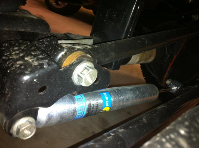

Ah ha! Just saw your pic... Pull off the Bilstein ss, put stock back on and check your left pull. 15 min check and may save you much time and $. If after the stock is back on you still have pull, then check axle and alignment. I speak from experience.

Can this be done at home or do I need a lift and other stuff , I got basic tools at home !!!!
Old Feb 3, 2012 | 04:50 PM
  #36
Bubbacon's Avatar
Posts: 733
Def do at home... It will take you just a few minutes... Basic socket or wrench. Do a quick search on the forum or google... Step by step with pics are out there. This is very basic wrenching. You will be fine.
