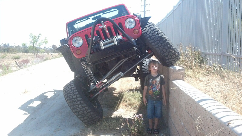

Stock arms don't max out till you are over 12" travel, but by that point you really need long arms anyway. Here is one (not mine) from another forum. I'm not saying to not replace the arms with a better flex joint, but they are by no means the limiting factor. Click image for larger version

Cool pic! I want his lift! By color of springs & stuff Metalcloak???

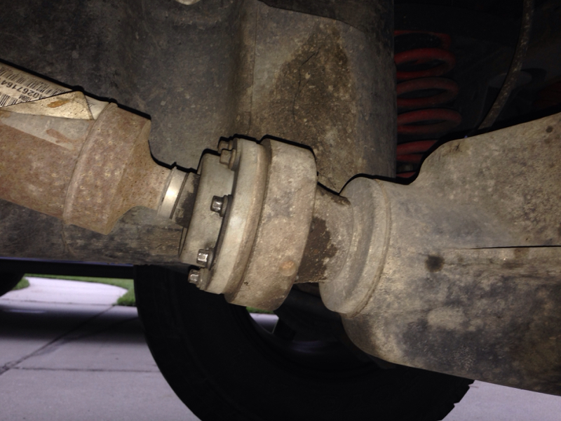

This might be off topic but I have a two door jk with 3.5 inch of lift and 33s. I recently bought front and rear drive shafts with double cardan joints on the transfer case side. I know the pinion should be in line with the shaft but whoever lifted my jeep didn't change control arms so I have factory ones but would I need rear control arms for the rear pinion angle

You could get control arms or go to a shorter coils. With 33's 2" is more then enough lift.

But if I stayed at 3.5 inches would I need adjustable control arms?

you don't need them now do you?
