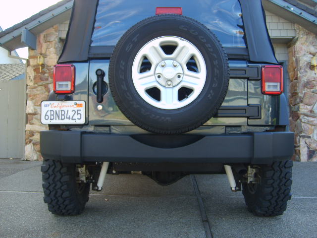

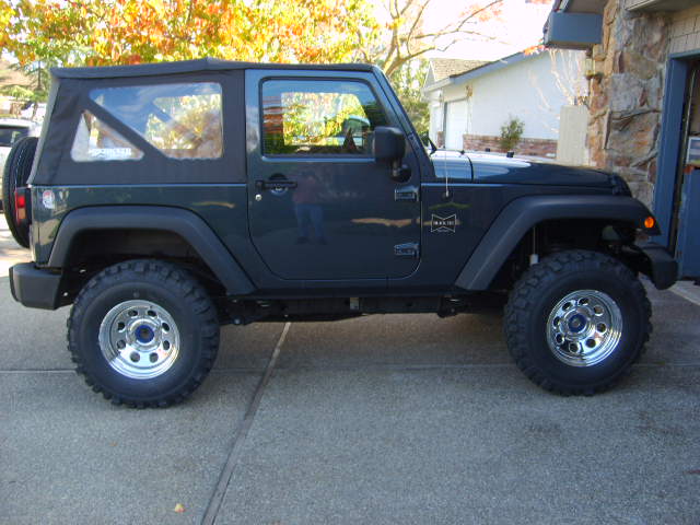

Installed my new Swamper 34" LTB's yesterday, although their not really 34", prolly 33"s.

The LTB 34" tires are either 33.6 or 33.8" in Diameter, so, they ARE 34's....pretty much ALL tire sizes are nominal anyway...so pretty much ALL 34's are in this size range...and, 33's would be mostly in the 32-33" range, etc.
