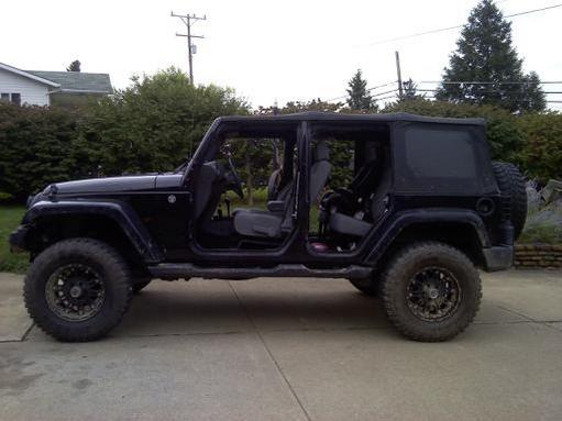

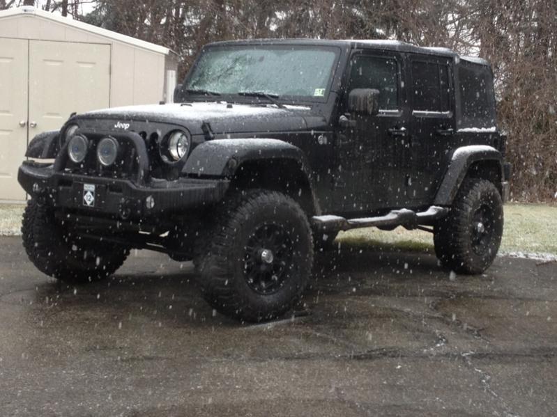

I'm pretty much in the same boat as you. I'm a big fan of the 305/70/17 (34.0/12.0/17) tire size for a lightly wheeled DD with a D30 up front. Anything bigger or more moderate wheeling and the C's and axle shafts can become a liability. I have 4.10's and it drives fine.

Do you have any pics of your rig with the 305s? I'm on the iPhone app at work and can't find any on your profile.
