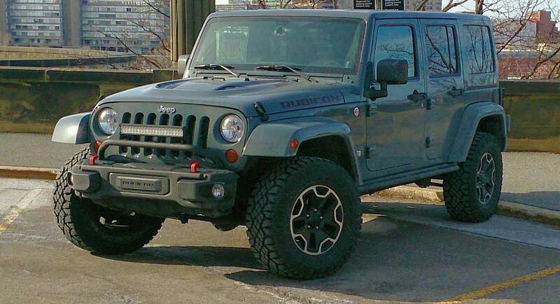

I chose 285/70, because I wanted the less impact on power, given that I do not plan to regear. My 10A came from the factory with a 1/2 lift, so I only installed Teraflex 1 inch front and 1/2 inch rear spacers. Again, I wanted the less impact possible on the whole suspension geometry. I chose to keep the stock 10a wheels cause I liked that it looks like a 10a, but had to use 1 inch wheel spacers to regain rubbing free full turning radius. Looks broader shouldered and just right to me. [emoji41]Click image for larger version
