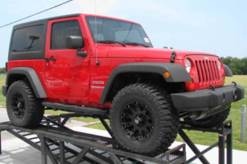

I've been very pleased with the look & handling of my Mickey Thompson Baja MTZ 33's on 17" KMC XD Misfits (see my avatar pic).
...great on street & off.

Something to consider...

Sorry... had to download an app to rotate this pic so I could use it. Perhaps a better 'big picture' pic...
Looks great, thanks for the picture
