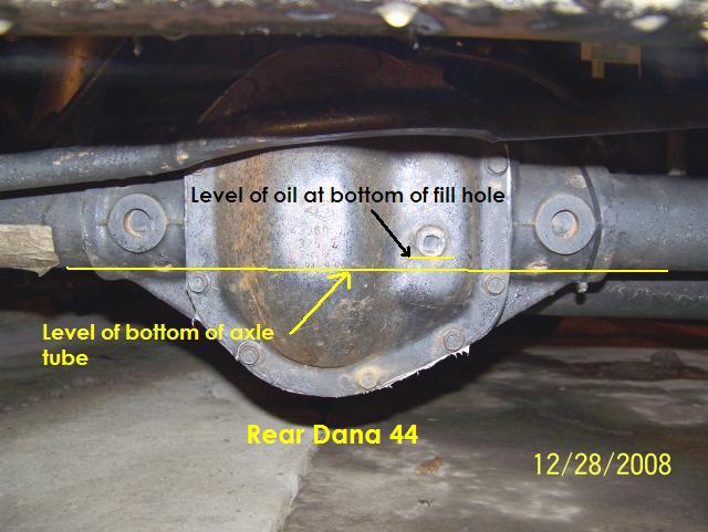

Different covers change the capacity. Here's a fool-proof method that works for this fool.
Take a zip-tie and bend 90 degrees to use as a dip stick. Look at the stock fill hole on an un-lifted Jeep if you doubt my advice.
Fill the diff to here:

this is exactly right.. to remember its just above those bolts in the pic... i didnt go by the amount they took, i went by the height of fluid.
