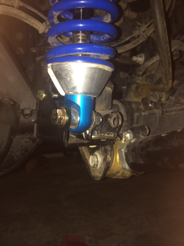

I am in the process of installing my bolt in evo front coilovers and have run into a challenge: I have a PR44u and the lower spring brackets are a little off I think....has anybody installed this kit with a a Dynatrac PR44? How do the lower brackets go in correctly or do I even need them?

Gonna need more info to help you out. Do you have any pictures?

Attached

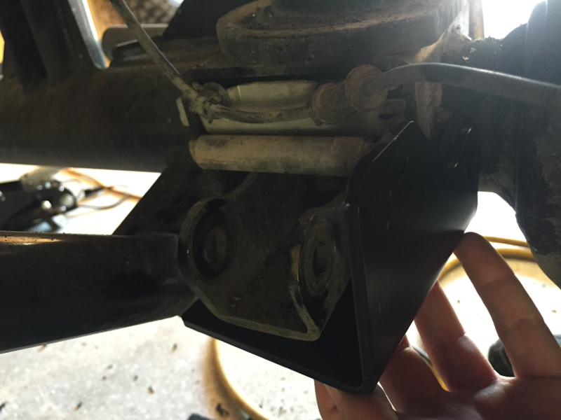

I am in the process of installing my bolt in evo front coilovers and have run into a challenge: I have a PR44u and the lower spring brackets are a little off I think....has anybody installed this kit with a a Dynatrac PR44? How do the lower brackets go in correctly or do I even need them? <img src="https://www.jk-forum.com/forums/attachment.php?attachmentid=622391"/>
You have that bracket on the wrong side.
Attachment 622401
was going to say this prior to reading down.
You have that bracket on the wrong side. <img src="https://www.jk-forum.com/forums/attachment.php?attachmentid=622401"/>
^^^^Yep. Attention to detail is important.

So, a follow up to this old thread. I did cal EVO that day and was informed that the PR44u axle does not require these brackets to be used with their coil over system. Just with the stock axle.
