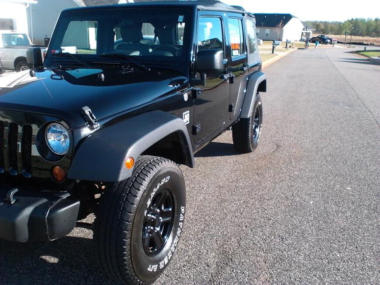

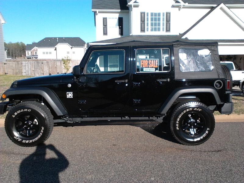

I painted my steel rims, with duplicolor universal black. It was the same paint code as my black jku. It made them look great, and it only cost about 30$ with two cans and clearcoat.
ID:	148355   Click image for larger version
Did you paint them with the tires mounted?
Old Apr 10, 2011 | 04:36 PM
grayandashleyunlimited's Avatar
Joined: Apr 2010
Posts: 306
From: Boiling Springs, SC
Yes. I wet sanded with a very high grit after a good cleaning. I dried them and taped them off as close to the rim as possible with flexiable painters tape. Used some masking tape and newspaper I finished off the rest of the tire. Once done with two coats of paint, another wet sand and two coats of clear, I used a tube of the same paint code touch up paint to get anything close to the tire I may have missed. Next time for sheer ease on my new jk I will do it before I replace the tires.
