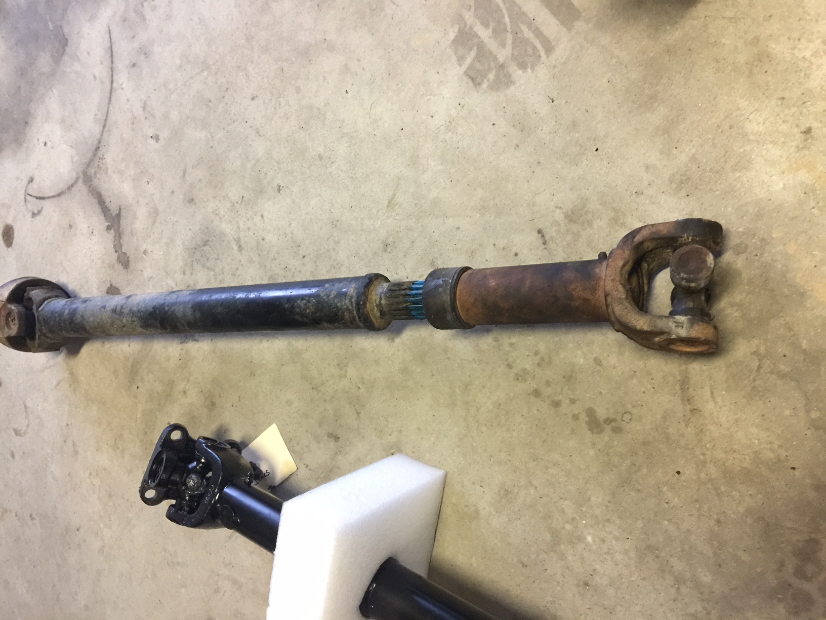

1: driveshafts. Definitely not stock. Front has a yoke on both ends - no flanges. Anybody have any ideas on this? Discovered this curiosity trying to install my Adams shafts. The CV joint was making a ton of noise on the old one (it's trashed), but I didn't catch they weren't stock till I pulled it, as this is my first jeep.

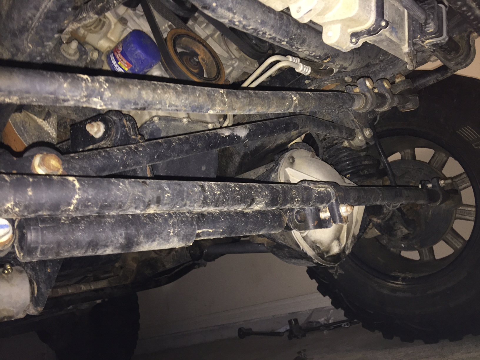

3: Front suspension (general): have a couple pictures here. Was hoping some more experienced members may be able to dissect this and let me know if anything else doesn't look stock.

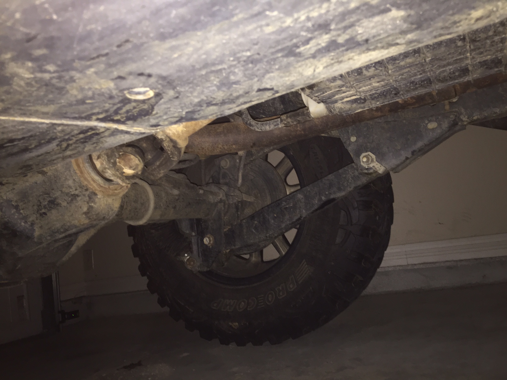

4: Rear control arms: lowers don't look like any stock pictures i can find, but the uppers do. Any clue here?

It looks like you're missing a clamp on one end of that tie rod (where the rust spots are)

Thanks! After some more research this weekend, I think I have some idea what's going on. Being that it had ProComp MX6 shocks (and all the other 4 wheel parts goodies) I had just assumed the lift was ProComp, but looking in the wrong direction since I had always thought it was a 2.5" lift. I believe this to be a ProComp 4" stage 2 with a different set of front lowers. Everything else seems to match that kit, for the most part though. Main clue would be those boxed rear lowers and the reuse of the factory uppers.
I was also told that someone thought the driveshafts were Tatton. But I definitely don't want to give any bad impressions as I'm sure he makes a fine driveshaft / has solid joints. It was likely installed back in '11 when the 4k miles were put on the jeep. Then, I got it last year and have put another 15 on it with no service - so that's probably self inflicted.

Do you know what the purpose of the missing clamp is? I agree it looks like there should be something there.

The rod is rotated to adjust. Usually it's threaded on the inside of the rod with a slit. The clamp tightens the rod to the joint threads to keep it from turning once it's adjusted. It was probably aligned after being lifted and not torqued enough. The vibration would make it come loose and fall off.

That looks like stock steering with a really bent drag link, the track bar is some sort of aftermarket.... No idea how to ID that one.

Looks like the rear arms are the old design Pro-Comp.

I'm guessing the track bar was from the pro-comp kit. The drag link did cause me some alarm when I was first looking, but checking stock pictures, it looks like they have similar curvature...

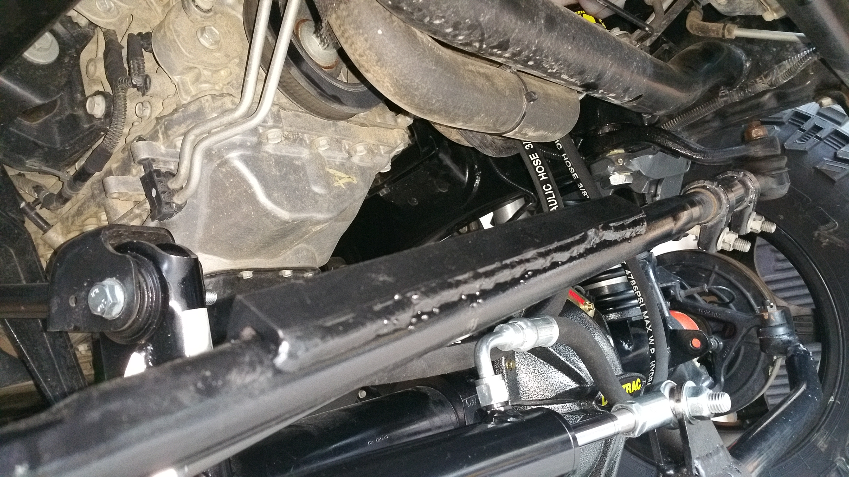

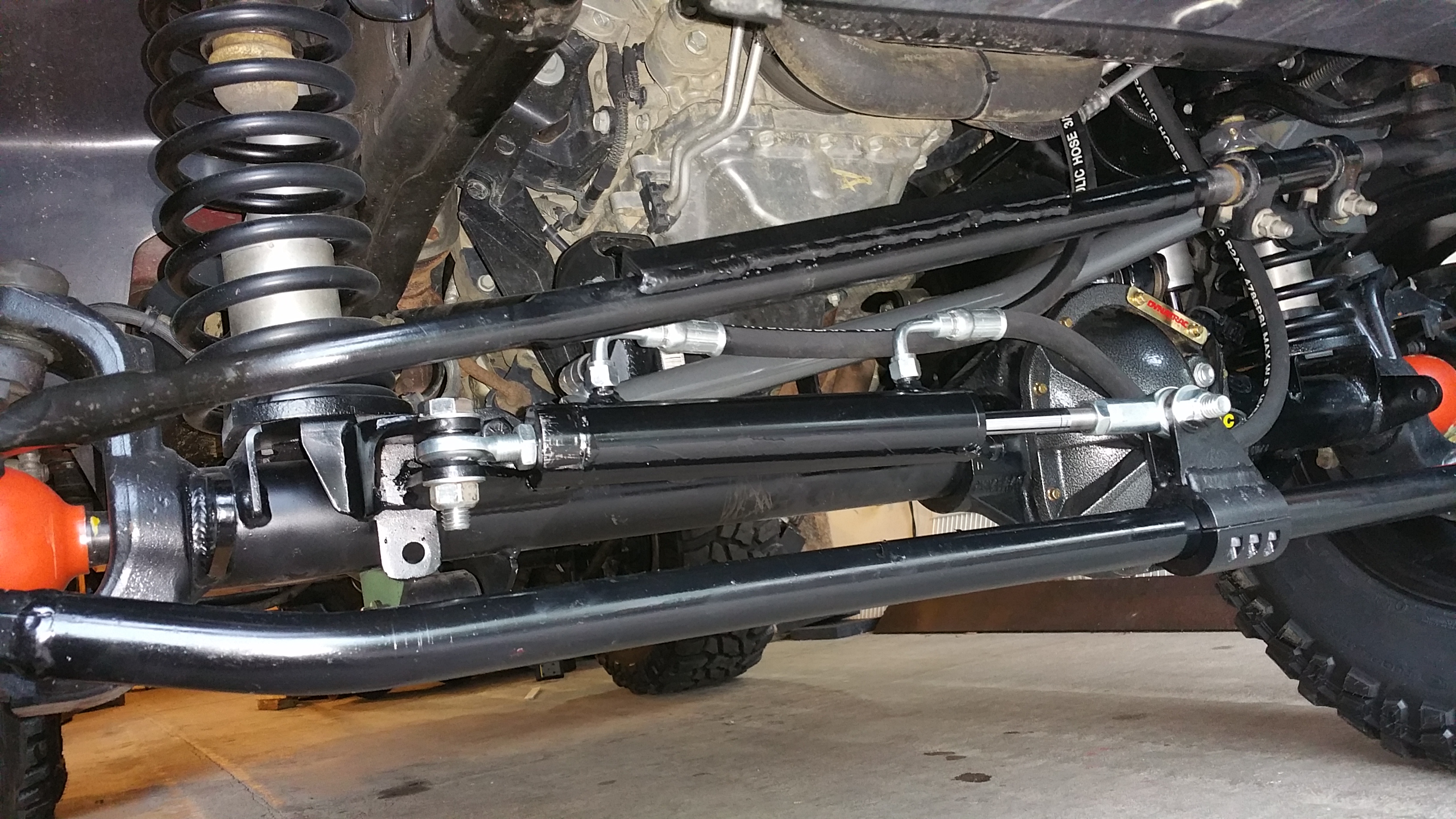

I don't know... it looks bent to me. This is my factory drag link that I modified 2 years ago with a length of heavy channel. It still lives a fine and happy life behind my 37" tires. Total cost.... a chunk of scrap steel and 2 beers worth of time. When it dies maybe I'll consider an upgrade, but I will likely find a low mile take off factory one from Craigslist and add my magic to it again :-)
