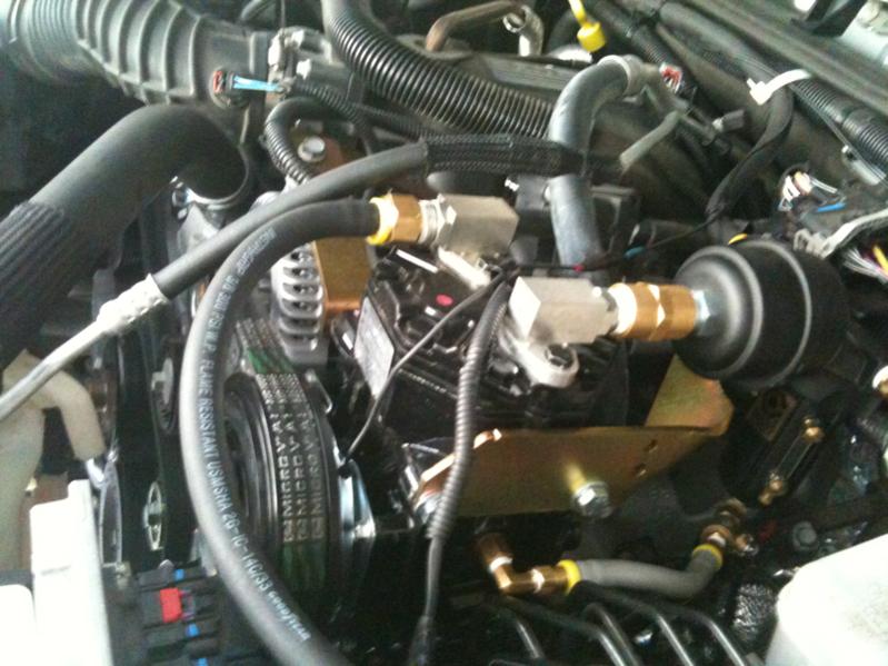

I am not sure if the electric air compressors can put out enough juice to handle air tools. The power tank is very capable of doing that, but you have the refill cost. Another option is the Kilby OBA. It has a hefty initial cost but can handle any task. I can fill up a 37" tire from 10 to 30 psi in 1 min per tire and use an impact gun or ratchet. I believe ORO makes a belt driven kit as well.

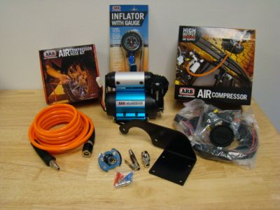

Just ordered the ARB Kit for the JK from Northridge Now the hard part waiting for it to show up.
