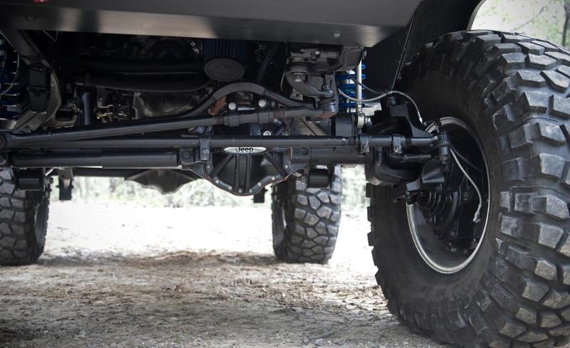

Could you take a picture like this? On a lifted vehicle the most common problem is the suspension alignment or the track bar being loose at the axle side. Sounds like you are talking about bump steer. Notice in the attached picture the drag link and track bar are parallel. Some times with lifts they do not end up parallel and it causes bump steer due to how the axle moves when it hits a bump.

Originally Posted by Space Monkey
Attachment 532298
Space
I'll get that shot.
