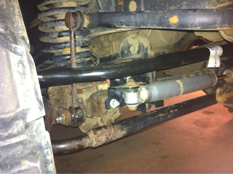

I currently run a 3" setup with a flipped draglink. It's perfectly parallel to the ground, just make sure you have enough bumpstop if you do flip it.

Drag link and tracbar have to run at the same angle as each other. If they are off its not too bad bit a smidge too much and bump steer.

What do you mean "bumps top" I have the teraflex bump stops installed that came with my kit.
Yup I run a raised trackbar bracket with my RHD Mopar draglink. Jeepin on a budget lol.
