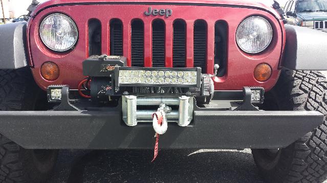

Pic looks squashed but its basically a 2x5 rectangular tube and a winch plate bolted to the rails.

Originally Posted by Sharkbait98
Pic looks squashed but its basically a 2x5 rectangular tube and a winch plate bolted to the rails. <img src="https://www.jk-forum.com/forums/attachment.php?attachmentid=508310"/>
so if i take say 4 monster bolts (1/2 in or 5/8?) and mount it to my bumper it will be strong enough? I dont wana rip my bumper off while stuck haha.
