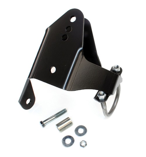

Old Jun 17, 2011 | 11:26 AM
mkjeep's Avatar
Posts: 15,665
From: Hammond Louisiana
ID:	172602Teraflex has one aswell for the rear axle
