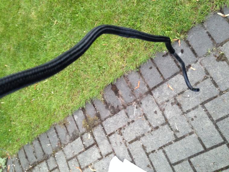

Mine Jk is 2014, I am trying to relocate the vacuum pump in order to install the bumper.
When I pull out the small hose from the back of the vacuum pump, the whole hose comes off. Now I could not find where I can connect the other side of hose?
Can anyone help me out? Thanks

There should be a little nipple for it to slide on over. Unless it broke off or something.

I believe that is the vent. I dealt with the same thing when I relocated mine under the hood. I just plugged the one end back in to the canister and routed the open end towards the drivers side firewall.

thank you for the reply, here is more pics about that hose.
so I can connect the hose back to the vacuum pump, on the other side of hose, just let it facing down and leave it somewhere. right?

Yes that is how I did mine. I'll post pics when I get a chance. I followed a write up on here or a YouTube video. And just made my own brackets.
