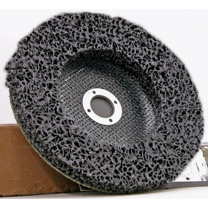

I removed the powder coating off the front bumper of my other vehicle once, just used an angle grinder with a paint/rust removal disc with minimal to no impact to the metal. I did line-x them, so it might not be the best idea if you are painting to match.

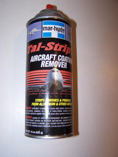

i had some powder coated wheels that i needed to strip completely to refinish and was told to use Tal-Strip Aircraft Paint Stripper. It removed the clearcoat in virtually seconds after spraying but didn't even put a dent in the powder coat.....Click image for larger version
