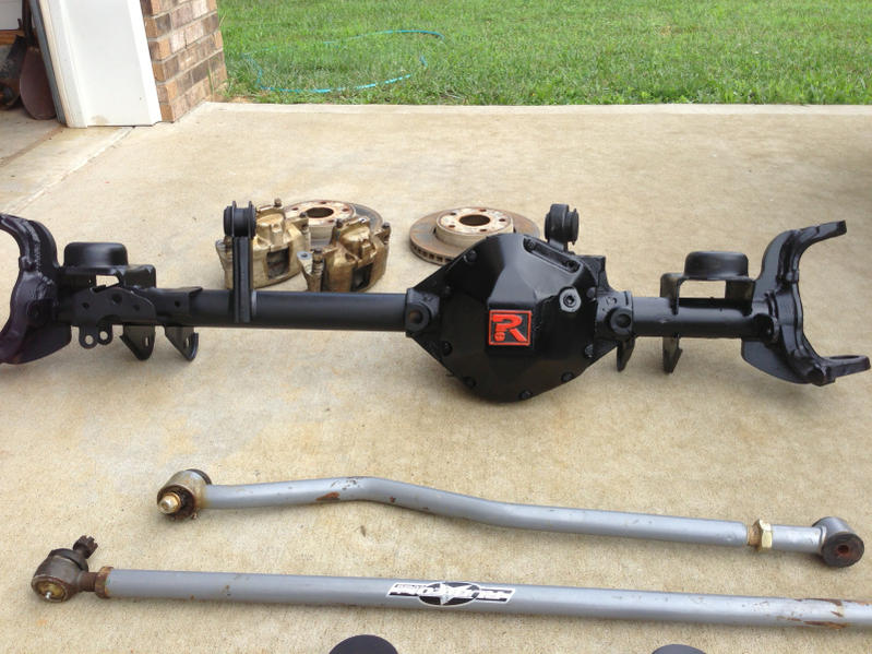

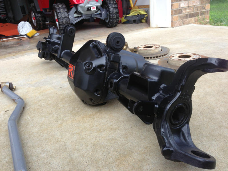

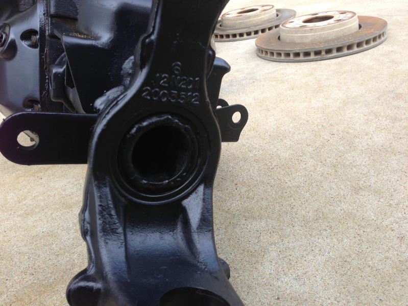

I have recently purchased 37s for my sport, so I am looking to beef the front up. I have found a Dana 44 front that is empty besides sleeved and gussets. I can get the locker too. My question is how much is the housing and locker worth and what all will it take to swap (parts wise)

Here's a few pictures

A new complete front rubi 44 is around $2700. A new bare front housing is around $925. A new front locker is around $1300. ( prices are from : Mopar Parts Discounted - Genuine OEM Mopar Parts Discounted up to 35%, Largest selection, delivered to your door , - dealer prices will likely be quite a bit more? )
Used prices will vary wildly. Maybe $700? (ish?) for the housing and locker. Some people are willing to pay a LOT more, but I wouldn't.
If you get the housing and locker, you will need gears to match the rear, or do both ends. And install or master install kits for each end. And inner shafts and joints from a rubi. The outer shafts can come from a rubi, or you can re-use your d30 outers. And outward from the outer shafts can be re-used from your 30.
If you choose to not get the rubi locker, your choices are a 35sp ARB, which will need 35sp axle shafts also, or a 30sp OX locker with the actuator of your choice. (if the housing has inner sleeves, the 35sp shafts may not be an option?)

He's wanting $1050 and its just the factory e locker. So I will prolly be better off buying a new one

Thanks for the advice and help by the way. I may take him up on the deal or keep looking or wheel mine till it breaks lol
