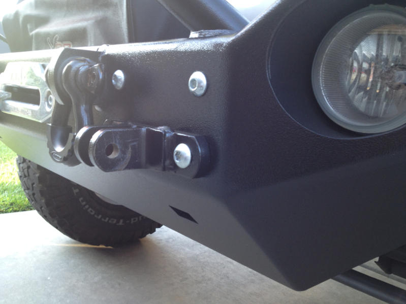

X2 on the Rockhard bumper. Will send pics in a short the wife has the jeep. ( yes I know ). She's a true keeper too. Anyway go to Rockhard . Com. You keep there d rings on and they have there own tow hooks / points. Road master or Rockhard that bolt right up to the frame through the bumper. Looks nice and clean. Like I said will send pics soon

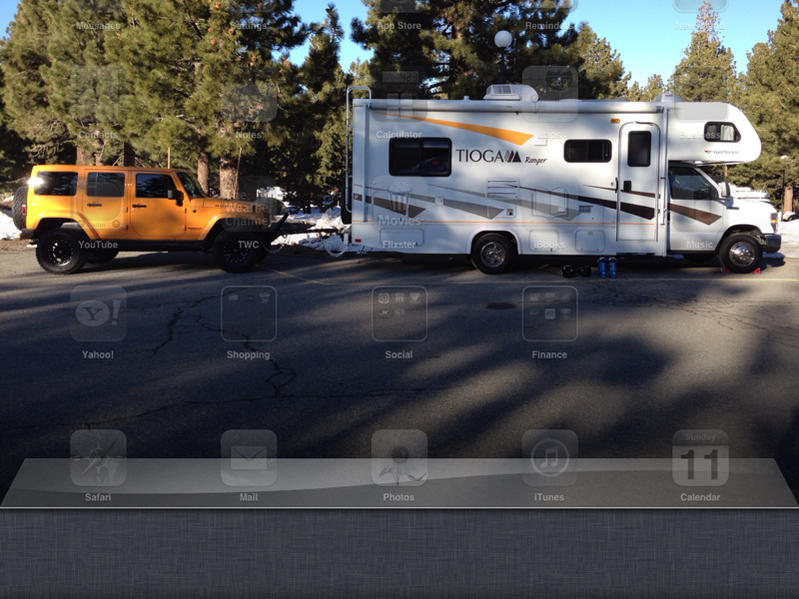

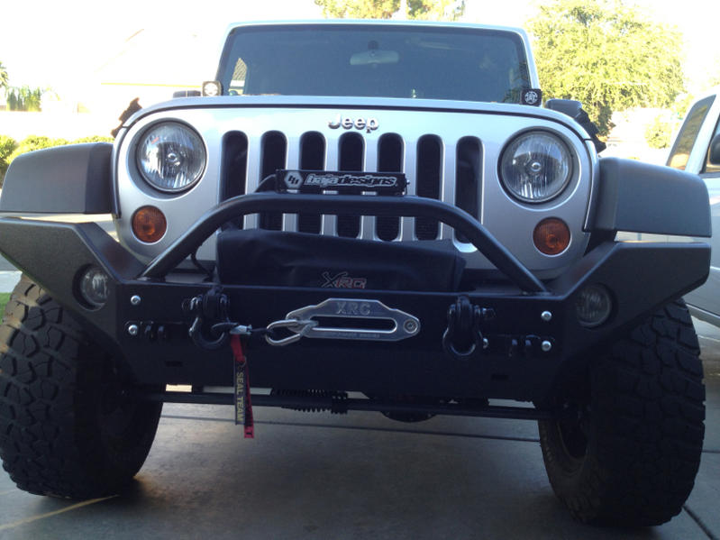

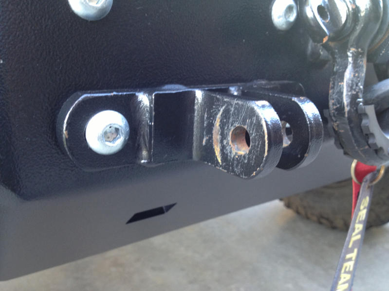

Hers the pic you were looking for. Again this is a Rockhard bumper. With their blue ox row points that hook directly to the frame

Good luck with your decision. Questions pm me.

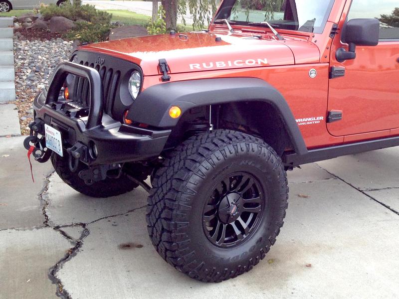

The AEV Premium bumper is also easy to adapt to flat towing. I just completed setting my jeep up for flat tow and it does very well..
you can kinda see the tow hooks at the bottom of the bumper..
