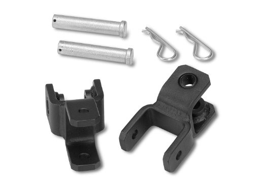

I have a smittybilt SRC bumper with stong D ring tabs on it. (see my picture of my 12 Rubicon)
I use a Roadmaster Sterling 6000lb tow bar to tow it behind my motorhome
I use a Roadmaster Even Brake to operate the jeep brakes. You need a braking system in the jeep to be legal and safe.
I have Warrior brand D ring adapters bought from amazon bolted onto the ends of the Roadmaster tow arms that then attach with cross pins to the D ring tabs on the smittybilt bumper.
heres a pic and specs of the Warrior Adapters

Warrior Products 867 Tow Bar D-Ring Adapter - Large 7/8 Pin / 3/4 D Ring
Search for the adapters on Amazon. You need that specific size and part number for the Smittybilt Dring tabs on the SRC bumper. It is a perfect fit to the Dring tabs and the roadmaster Tow arms.
Name:	warrior ring adapters 3.jpg
This combo has worked very well for me towing my 4500lb jeep all over the country including mountains for over 5000 miles!
If you choose to go the way I did be aware that the specific Dring size on the SRC bumper is a perfect match for the Warrior adapters and the adapters fit perfectly on the Roadmaster Sterling tow arms. That would not be necessarly true for other makes and combinations. I just know that this works for my rig and I have read other posts on this forum of the exact same combo working.

• I've got an 07 2-dr Rubi that I recently installed a Hanson front bumper one. I though about having modified brackets fabricated and welded on and chopping up the front skid to make room...none of that was easy after dumping that amount of cash into that bumper. I looked online at Warrior Products part WAR867 tow bar d-ring adapters. Of course they are not manufactured for Roadmaster tow bars but they worked perfectly.
For reference, my towbar is a Roadmaster Sterling, the older type, but they all seem to have the 1/2 inch cross bolt in common and I believe this would work with any Sterling including the all terrain. May be just as true for any roadmaster RV-mounted system but I can't say for sure.
The opening on the Roadmaster tow arms is drilled for a 1/2 inch bolt and is 2 1/4 inches inside to inside. I replaced the grade-5 bolts that came with them with grade-8 (they really are much stronger in shear...and not brittle as commonly believed). Added 1/8 inch nylon washers between the WP adapter and stock towbar ends to take up the slack - slight interference fit with no wiggle/rattle. Worked as close to perfectly as I could have hoped for. No mods to the bumper - hook to the d-rings and go!
