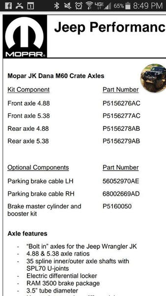

Mopar has an e-brake cable kit for the new 60s. See part numbers below for brake upgrades and cables. Highly recommend the new master cylinder and booster.
