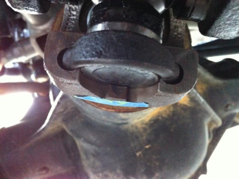

You also need to check the u-joints on your drive shaft. When I installed my front drive shaft I had a bad vibe over 45 MPH. I took it to an alignment shop to adjust my pinion angle, and it did not help. When I got home I realized the u-joint was not properly sitting within the groves before I tightened down the u-bolts.
You should have two little nipples on the yokes that properly seat the u-joint. Just make sure the edge of the u-joint is not tightened down on top of them.

Will defintly check that out! Thanks for pik.
