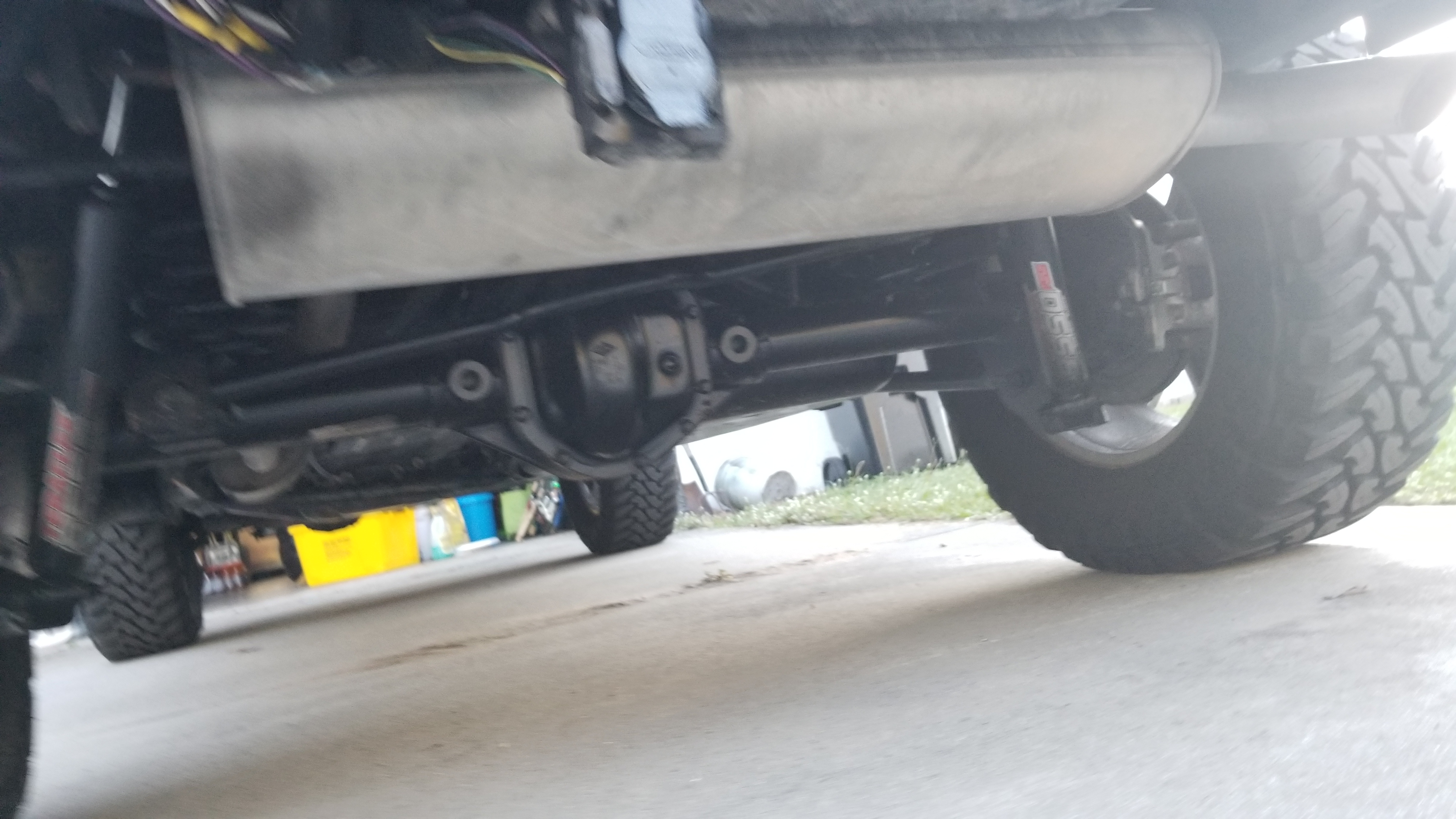

Start with this pic to measure lift height up front –
Keep in mind that actual lift height is going to vary a bit from what the springs might be. Depending on brand, some springs will net more actual lift, so a 2.5” spring might net 3” of lift. Anyhow, measuring actual lift is a starting point for you. Hard to identify springs. If they have Teraflex shocks on there likely that they are TF springs as well. Pictures are sideways so hard to tell, but looks like you have no front or rear bumpstops. I assume you do not have adjustable control arms on it. The factory arms should be easily identifiable. If they are factory control arms, and you see no cam bolts installed in the axle’s lower CA brackets, and you see no frame-side control arm geo brackets, you are running too low of caster which is not helping your driving situation. Factory caster is 4.2*, and if not corrected, most lifts will drop that down around 3* or lower, depending on height.
There is a chance you could possibly have a bad joint in a steering component, but your starting point is to get your caster set correctly and go from there.
Tire pressure can influence things......but 40-45psi is way too high IMO. For a 33, would think 30-34 would be more appropriate. You'll see many point to doing the chalk test on the drive to check for tread contact. There is no perfect hard and fast XXX psi as every jeep's weight is different due to mods.

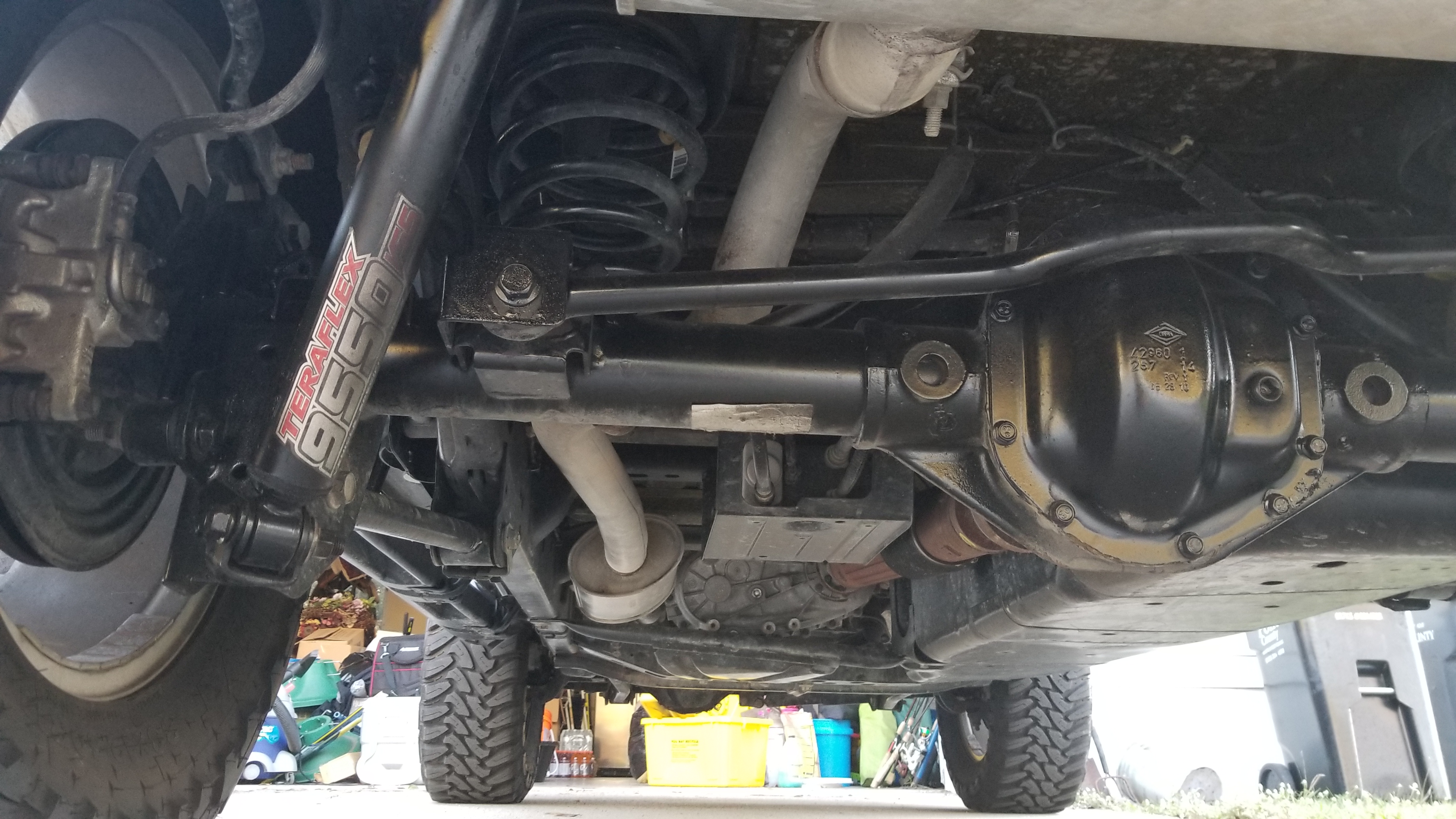

Oh, I also noticed you have no raised track bar bracket in the rear. You should have one with a lift. The flatter the rear TB angle is, the better the jeep's roll center is gonna be.
If you snap a pic of the front end components, we can easily identify if they are stock or not. BJ's, DL and TR are likely stock still.

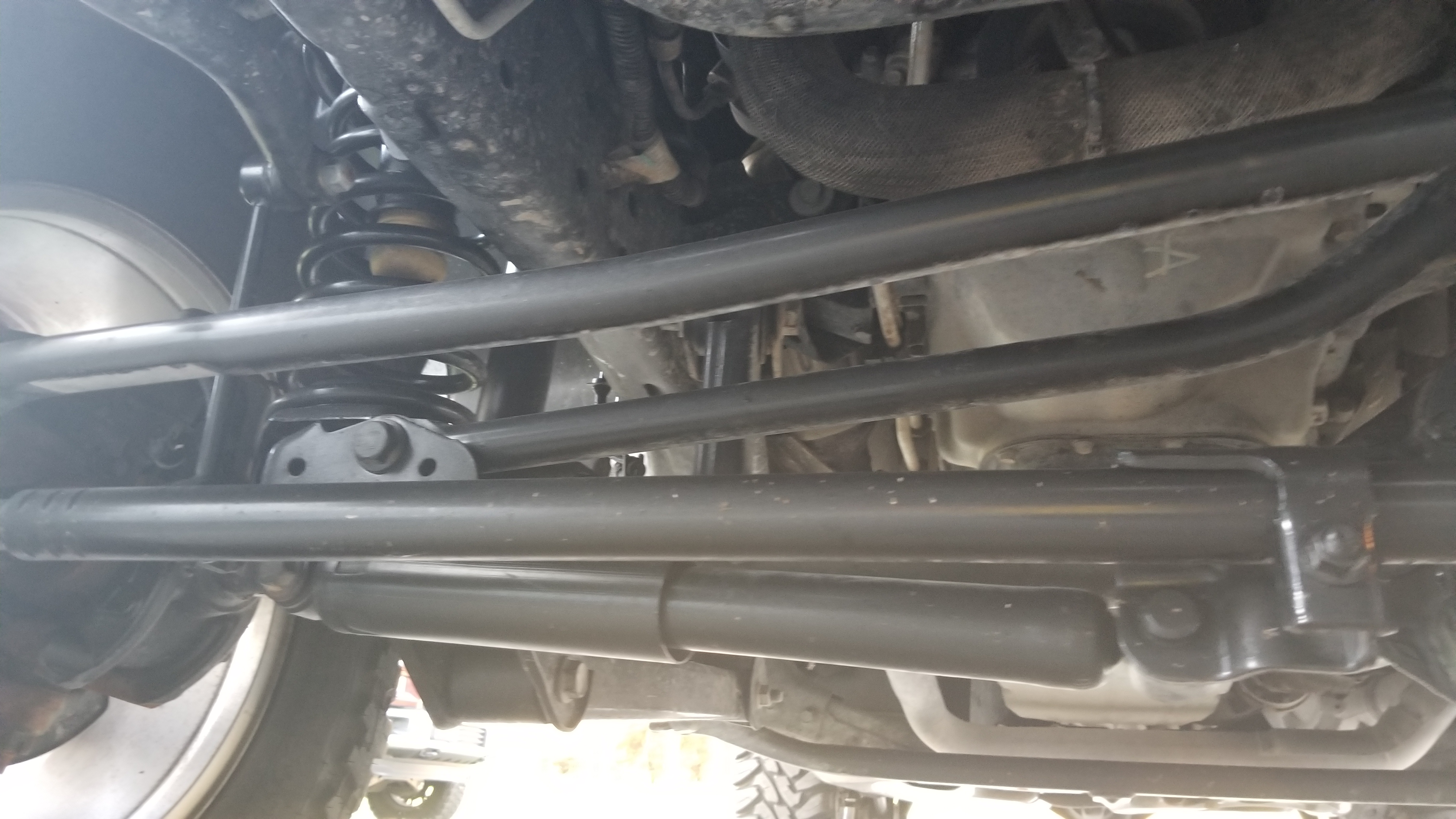

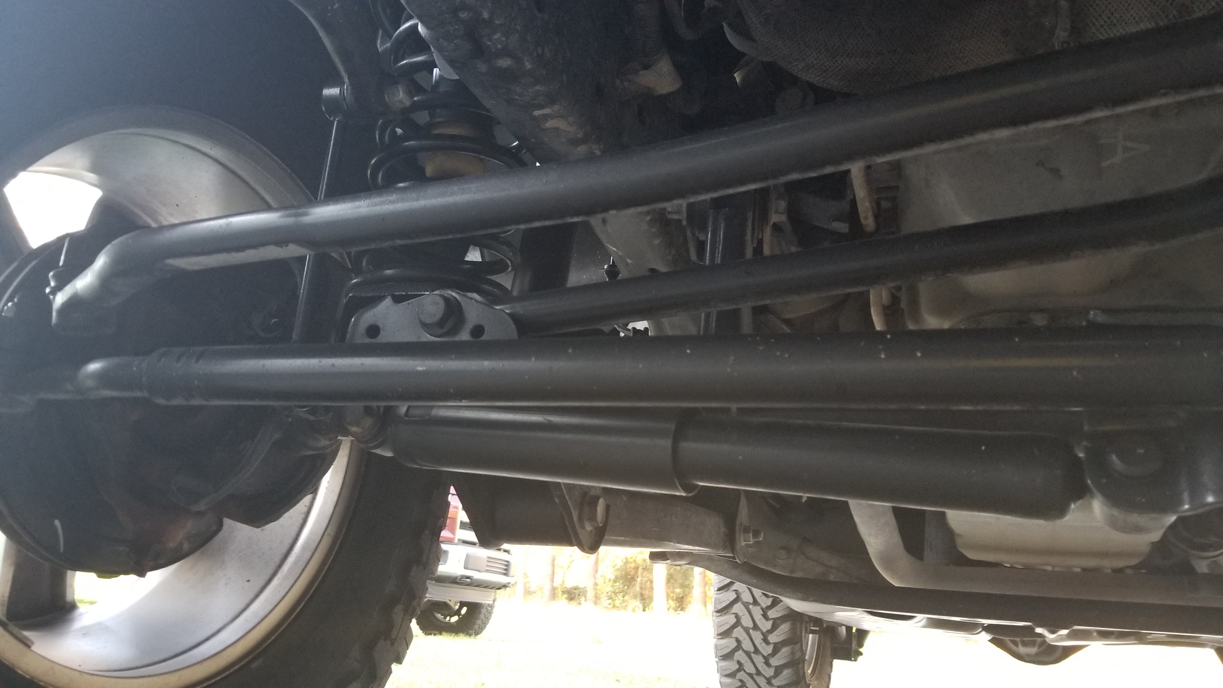

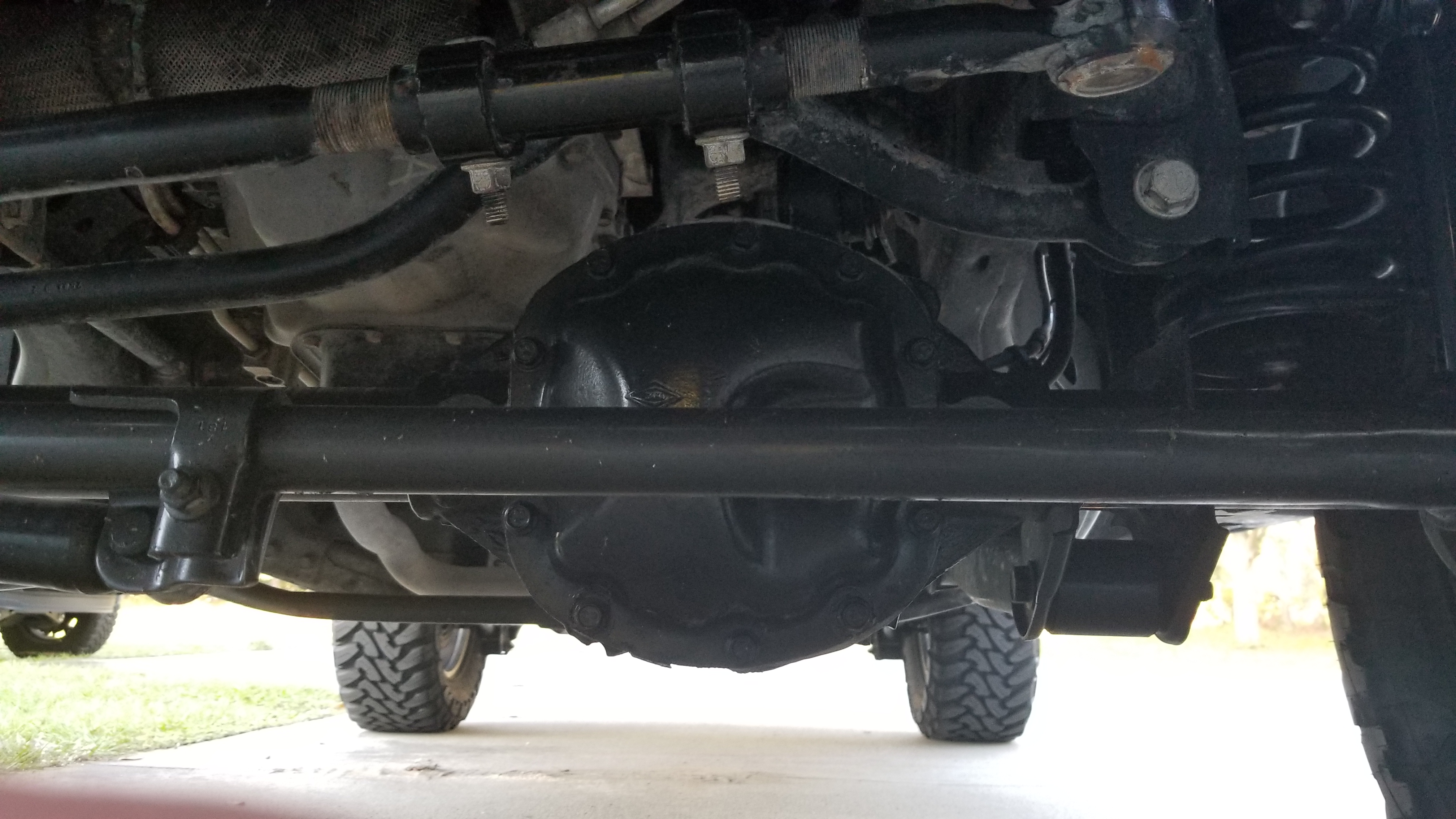

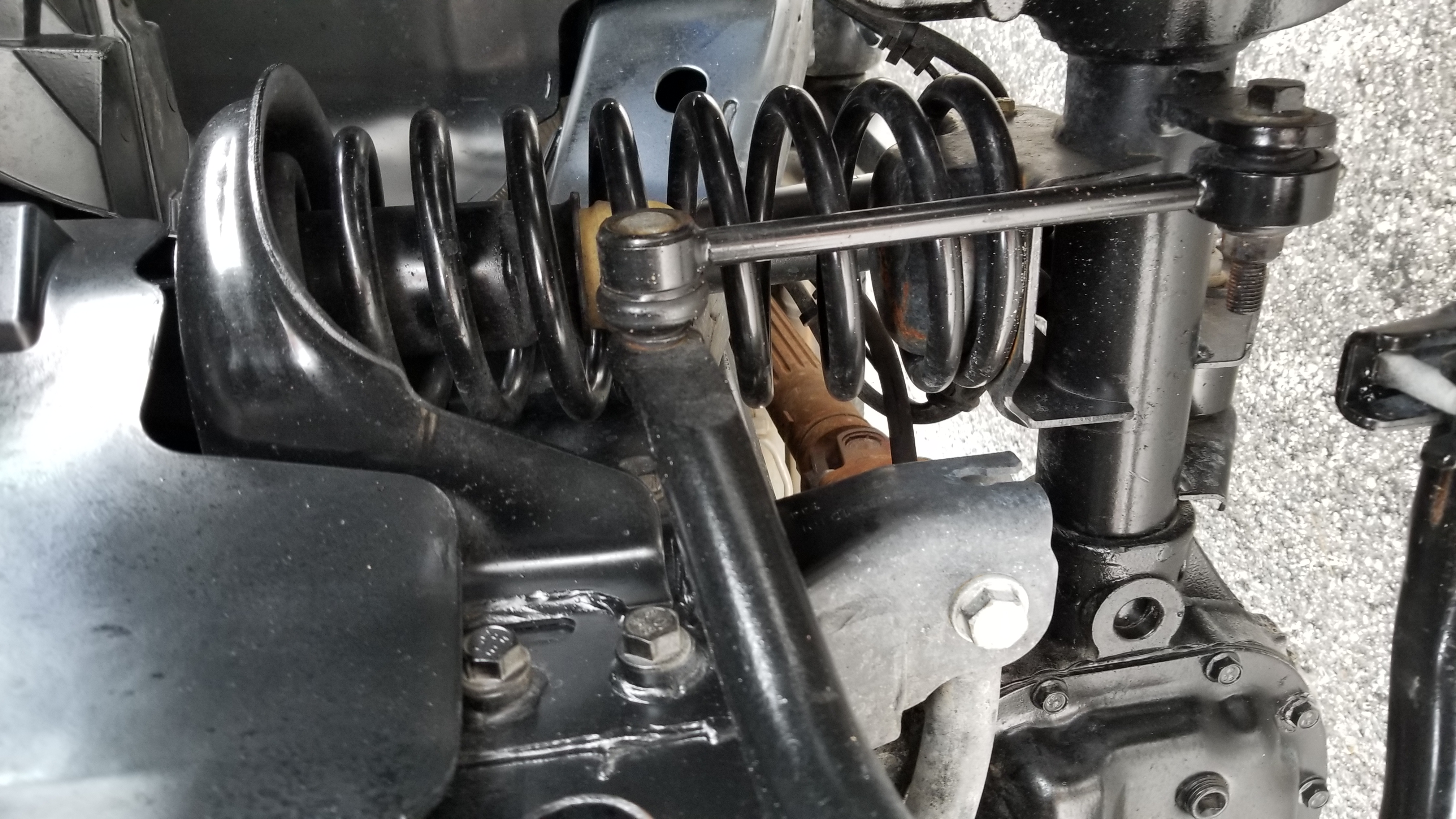

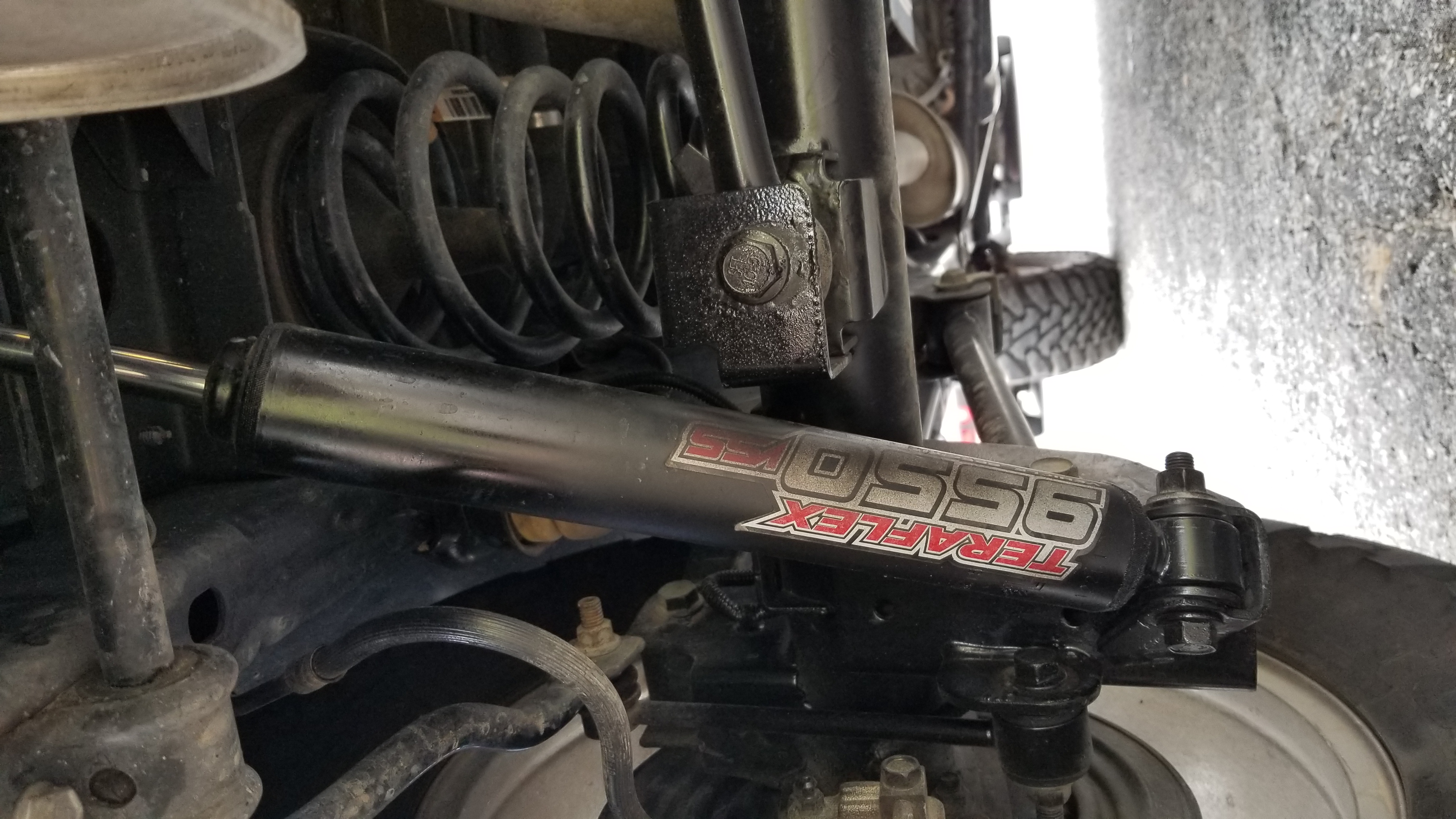

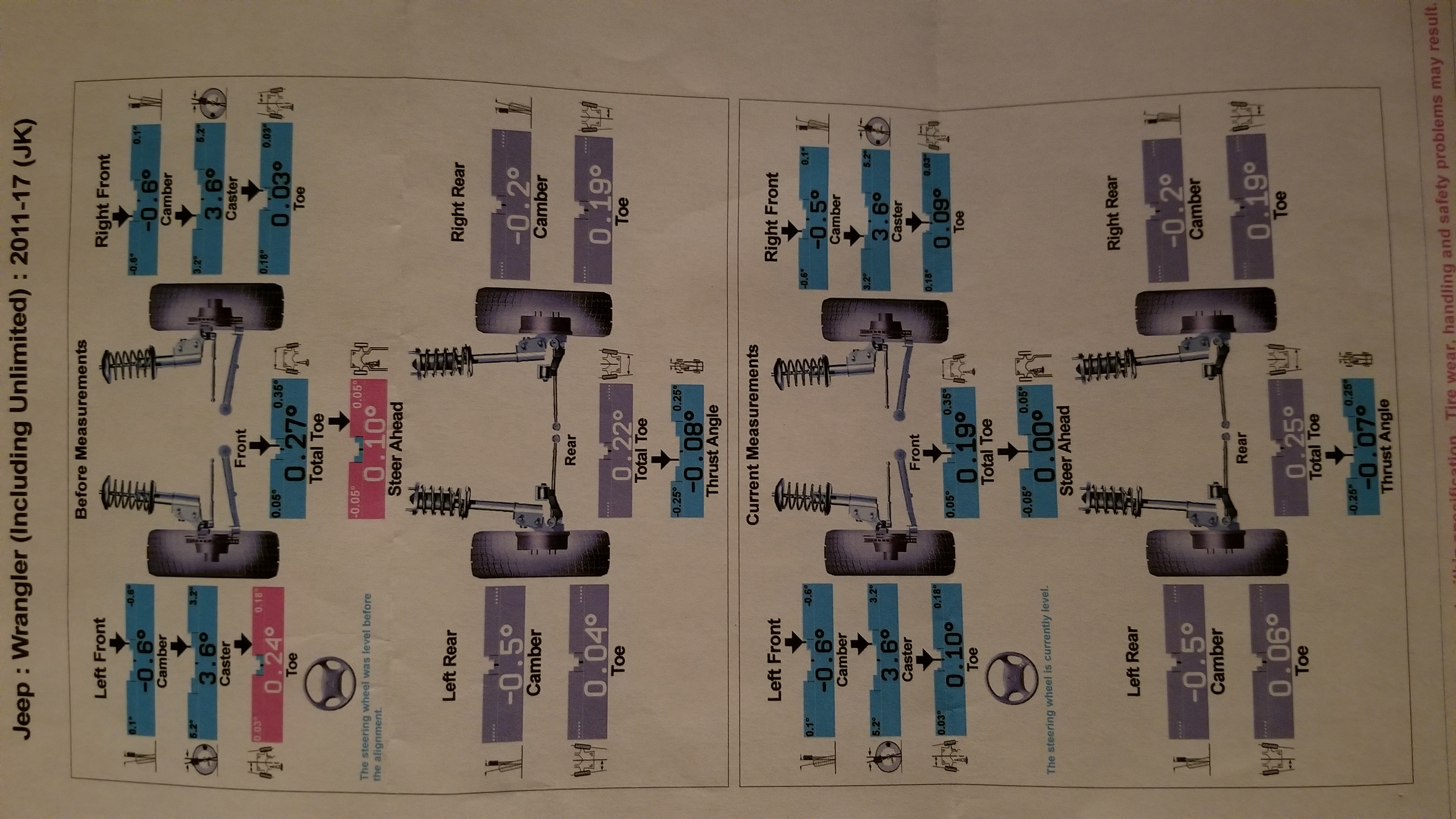

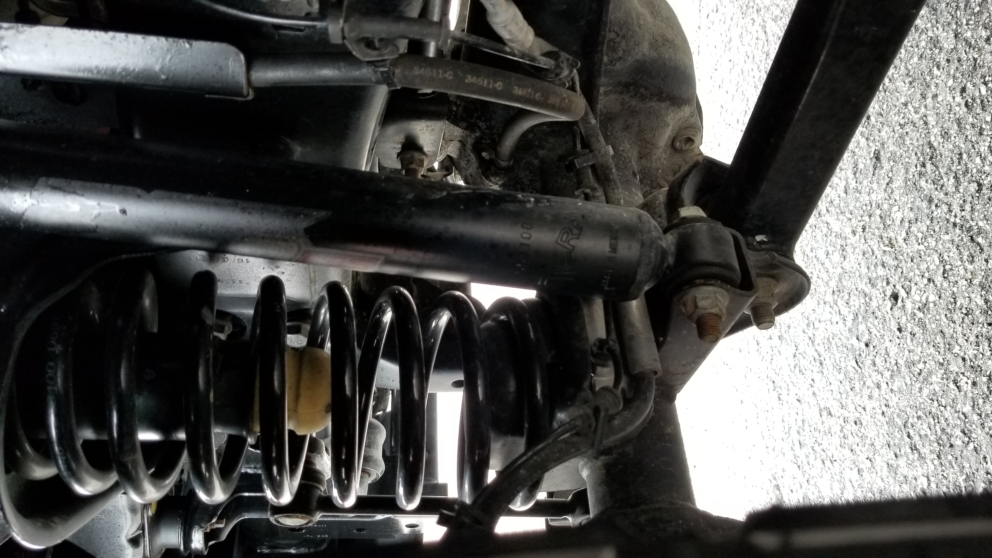

I've got some additional photos, but I still haven't been home with enough daylight and time to take measurements. I also snapped a pic of the alignment results. Any comments would be welcome. I think I see bump stops (located at the top of the springs?) but the previous owner tried to blackout everything, so he spray painted most everything in the wheel wells.
Bumpstops are a bit different. Front, the upper stops will be hanging down 'inside the coils', and the lower stop will be just a metal contact plate above the axle, again inside the coil. Rear, the stops will be outside the coils. Uppers hanging down, lowers just contact plates on the axle
Noticed the front upper bumpstop in one of your pics, it's the white rubber thing.
And in this one you can see the rear coil spacer, it has a long coil guide hanging down.
Some note needing bump stop extensions, and other things that I don't understand. Installation seems pretty straight forward. Is this a front and rear thing, or just rear?
When the front trackbar is raised, it is part of a high steer/draglink flip, where the drag link is moved to the top of the steering knuckle. Since the draglink is moved up, more bumpstop is usually required to keep it from contacting the frame. (I assume this is what you were reading about? Bumpstops keep the axle from moving upward to far.) Generally people start wanting to flip the draglink at 3.5 or 4" and higher.
The Caster is a bit low. Low caster causes flighty/wandering steering. Gets worse as you lift higher. Stock caster is around 4.2 degrees. After a lift, most people like to raise it up to 4.5-5* or so. Lots of personal opinion here. If you think the steering is ok, leave it alone. If you want to raise it, snap a few more pics of both ends of the front control arms. (guessing they are still stock, and no cams, but we'll need to know to make suggestions.)
