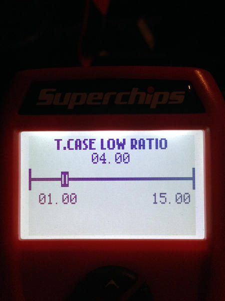

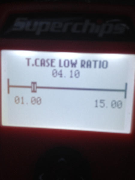

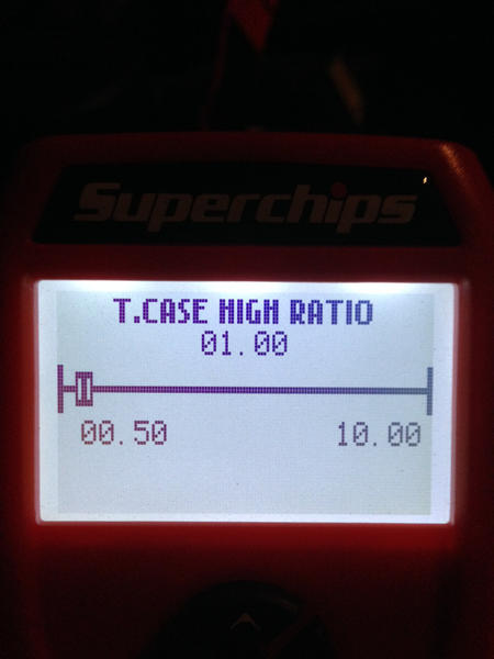

Hi all question here.... I have an 09 JKU auto X or sport model just installed a Rubi 4:1 Transfer case into it and now trying to Superchip tune it for the Hi and Lo t-case settings... I currently reset it both hi and Lo at 04.10 see 1st pic.... My buddy with a an 08 Rubicon auto has his set at 2 different numbers .... What's correct? Thx

1:1 and 4:1 are correct. Rubi case is 4:1 not 4.1:1

^^ Yep, your buddy is correct. It's 4 to 1 reduction. 4 low and 1 hi
