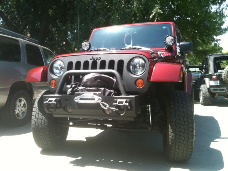

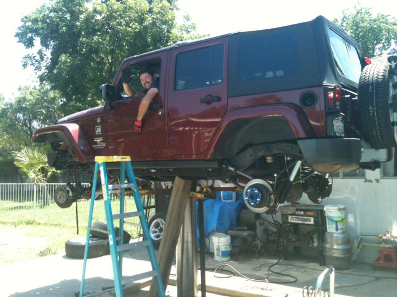

I have a FT 3" kit with control arms. It rocks!
If you want to keep your stock wheels, you'll need spacers, like 1.5" Spidertrax, to get proper backspacing when you lift your JK. You can see them in my attached pics, but only with the wheel off.
