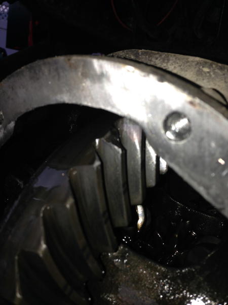

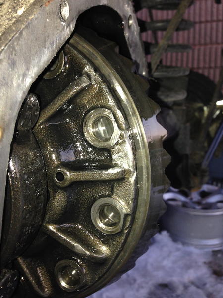

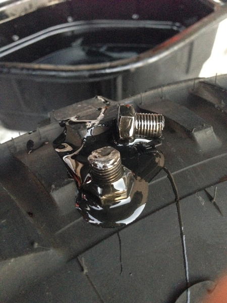

I Just swapped out my 3.21s for 4.11 with a complete kit from Nitro Gears from their distributer Just Differentials.
2500 miles later the ring has sheared off of the rear carrier leaving me with a broken ring, damaged carrier, bearings etc.
I called Just Differentials and they are claiming installer error. They are saying the bolts must not have been torqued or used with loctite.
My mechanic said that the bolts failed because they are too short and the shank does not match up to the carrier holes and that he torqued them and used loctite.
The carrier has 1/2 bolt holes and the nitro gear ring is for 7/16. Upon further discussion with Just Diff. they claim its "OK to use 7/16th bolts in the 1/2 inch holes."
I asked them why that most of their other ring gears have threads for both on the same gear and so does the competition. Just Diff. replied that it depends on the size of the gear and their larger gears need it but the 4.11s do not.
I am now $900 in the hole PLUS labor (not including the $2400 the gear swap cost me the first time.
Anyone else have this problem and can provide me a little assistance?
Thanks for any help.

If your mechanic knew the bolts were too short,, WHY THE HELL DID HE USE THEM!!!!!!!! Sounds like he just admitted the instal failure was his!!!

He used them because they were supplied by nitro. He thinks they may have been too short but they torqued up. It's just a possible hypothesis of why they failed.

I imagine the 7/16" bolt allowed the ring gear to move around since the shoulder was smaller than the hole in the gear. This would allow a lot of shear forces against the bolt. It sucks to have issues like this!

The short bolts where the cause of your failure. The bolts being too short does not spread the load far enough over the bolt to make them effective. As far as who is responsible for the failure, you are. After your mechanic told you the bolts where to short you should of stopped him until it was resolved. Second buy gears from a quality manufacturer who stands behind there product.
