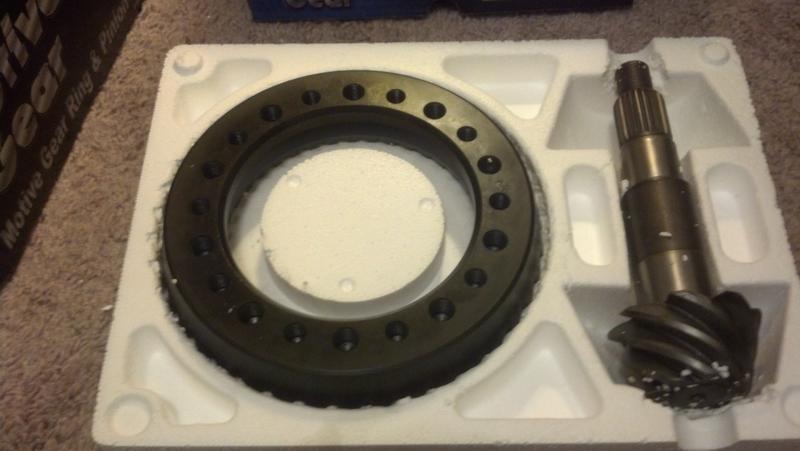

BTW: My Motive rear gear came drilled and tapped fro both 7/16 and 1/2 and included bolts for both.
Attachment 517521
Attachment 517521

All gear manufactures should make their rings threaded for both. I hope this thread helps educate people.
Thanks for the pic.

The second ring they sent me was threaded for both 1/2" and 7/16th hardware. (they still only supplied 7/16th)
I sourced new 1/2" hardware from a local performance shop/Dana specialist, and used it for the install of the new ring.
