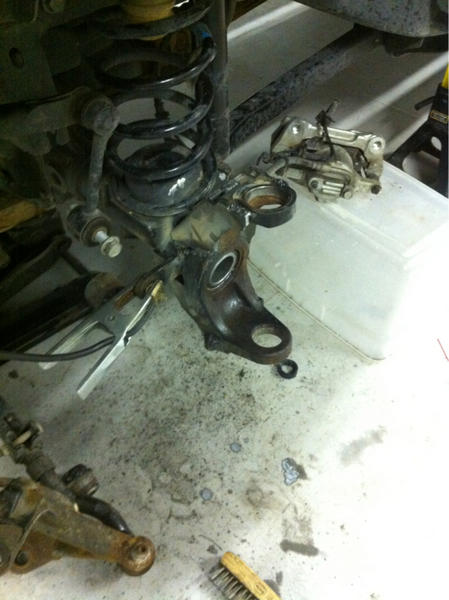

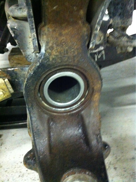

I second that they are easy to install. I actually had more trouble with the short side than the long side. I froze them and used white lithium grease. Had a buddy build the tool and installed them by myself. There that easy!!!
