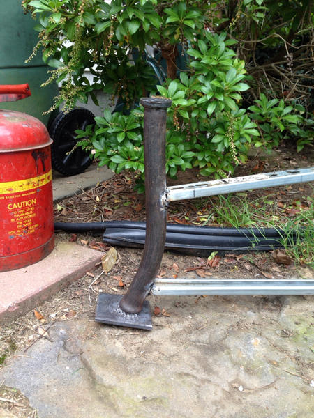

I have to say the install of mine did not go as smooth as I read here. It makes me wonder if my axle tubes were bent a little. I froze the sleeves for days prior to install and cleaned the tubes well. Made a tool to bang them in with black steel pipe. After a lot of banging with a15lb sledge hammer the tool was so warped and the sledge hammer handle broke I almost didn't get them all the way in.
