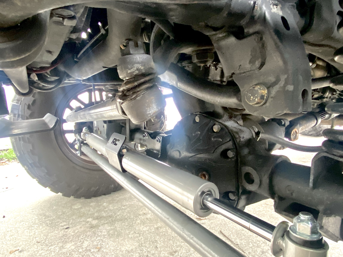

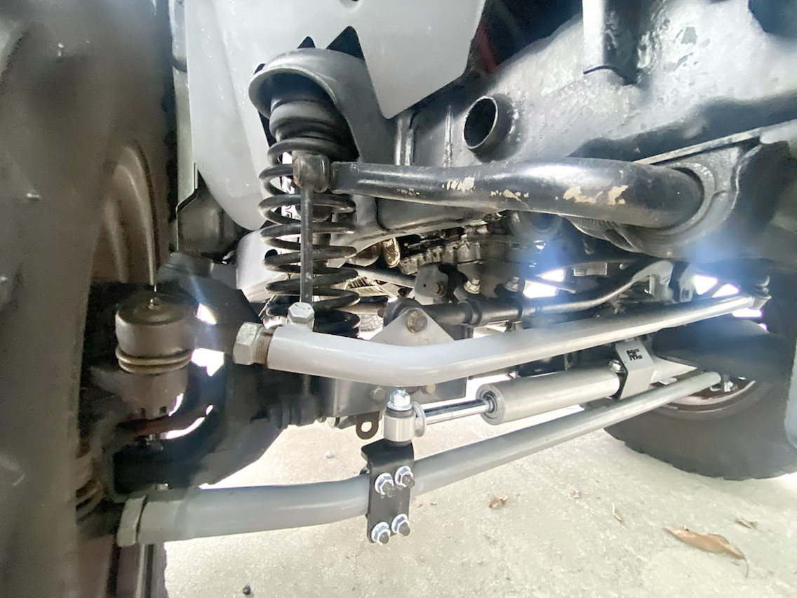

I don't know if I can go too much lower then 25 PSI for daily interstate driving... About the drag link flip, I think I may already have one. Can someone confirm? (Video in link)
Does anyone else feel like the steering wheel is not tight enough. Like there is too much play ? I can turn it an 1-2" left or right before it actually turns . Then if I hit a bump or hole, you feel the 1-2" play in the wheel
Yes, you have a DL flip installed in those pictures. The play in the steering wheel does not seem normal.
