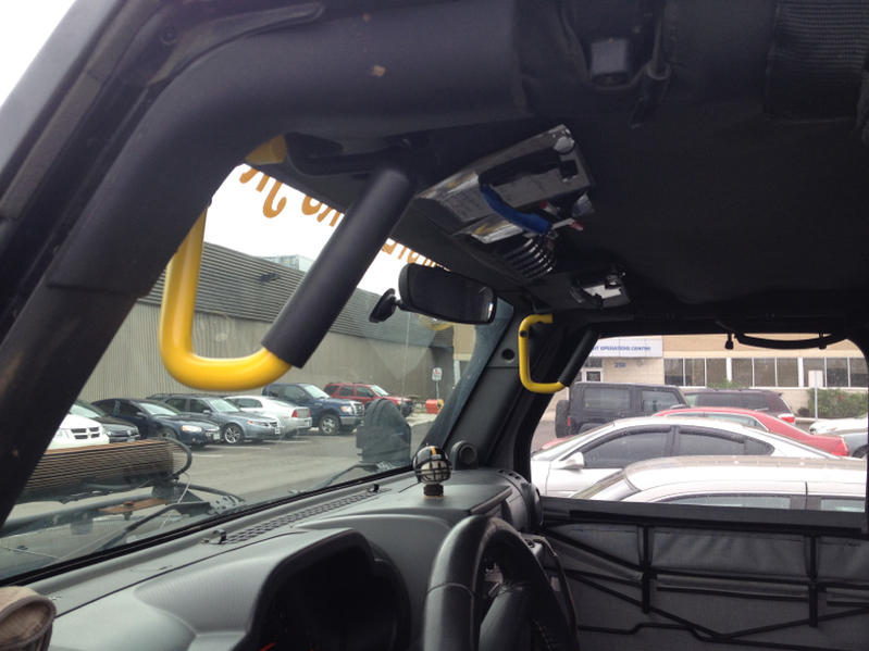

Hmmmm strange I installed mine front and back last month 20 minutes tops!!! Sorry about your experience 2009 JKU
ID:	570051   Click image for larger version
