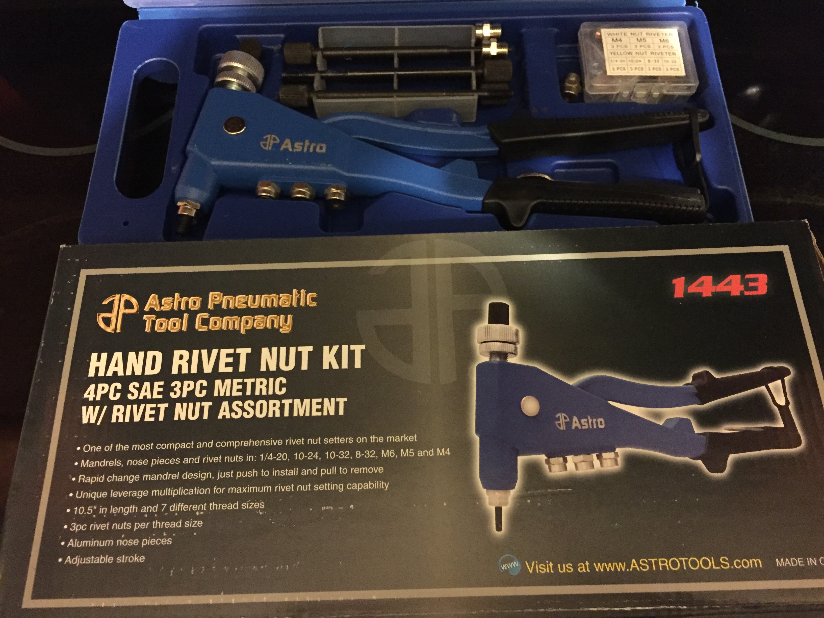

Make sure you buck them really good. I had one that started to spin the last 1/2 inch of the bolt and I had to take the entire fender off and drill it out and do it again. Thank god I did not oversize the hole and I was able to put another M6 Riv-Nut in with no problems. I say no sillicone could make things worse.
