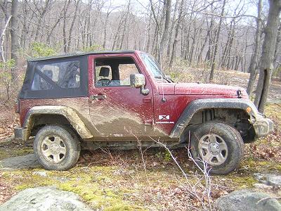

Greetings Everyone,
I've been lurking around the forum for awhile and finally thought I'd throw some questions out. I am new to the off-roading and jeep thing - growing up in NYC and just getting a taste of all this stuff over the last 3 years. I've only had a Honda civic... and that was for about 10 months.
I just purchased a new 07 JK X, auto, with the trailer package, rear LSD, hooks, and stock everything else. I've had it for about 4 days so I am still learning the finer points of the jeep but am having a great time.
My questions are on where to start on mods. After going out on Saturday for some trail riding out in training areas I realized pretty quick I need a lift to follow my buddies out to some of the more exicting places without destroying my skid plates. After reading through many of the comments here, I am looking into the Teraflex 2.5" BB. If I go this route should I try and look for some rubi shocks or takr the tera's. After that I will probably get some better wheels and work from there. Is this a good beginning or am I over looking some other basics to start out with? Are there better lifts? I am on a budget so trying to make the best of what I can get.
Thanks for all your help.
-Chris

sounds like a good start for a budget mind person. Remeber ground clearence is in the tire not the lift. you can do 33s stock height

I agree. Just get some 33's and you can go almost anywhere. If you have any slight rubbing issues add a spacer up front. Or buy somebodys used Rubi wheels and tires. Depending how many miles are on them you can get them for under a grand. That will help you out.

I agree with the 33s, but aftermarket wheels may be a better choice! If you get something like the Cragar soft 8s with 5" backspacing, which only run 50-60 bucks then a good set of tires, you can still get the 33s on there and a much wider tire without the rubbing!
