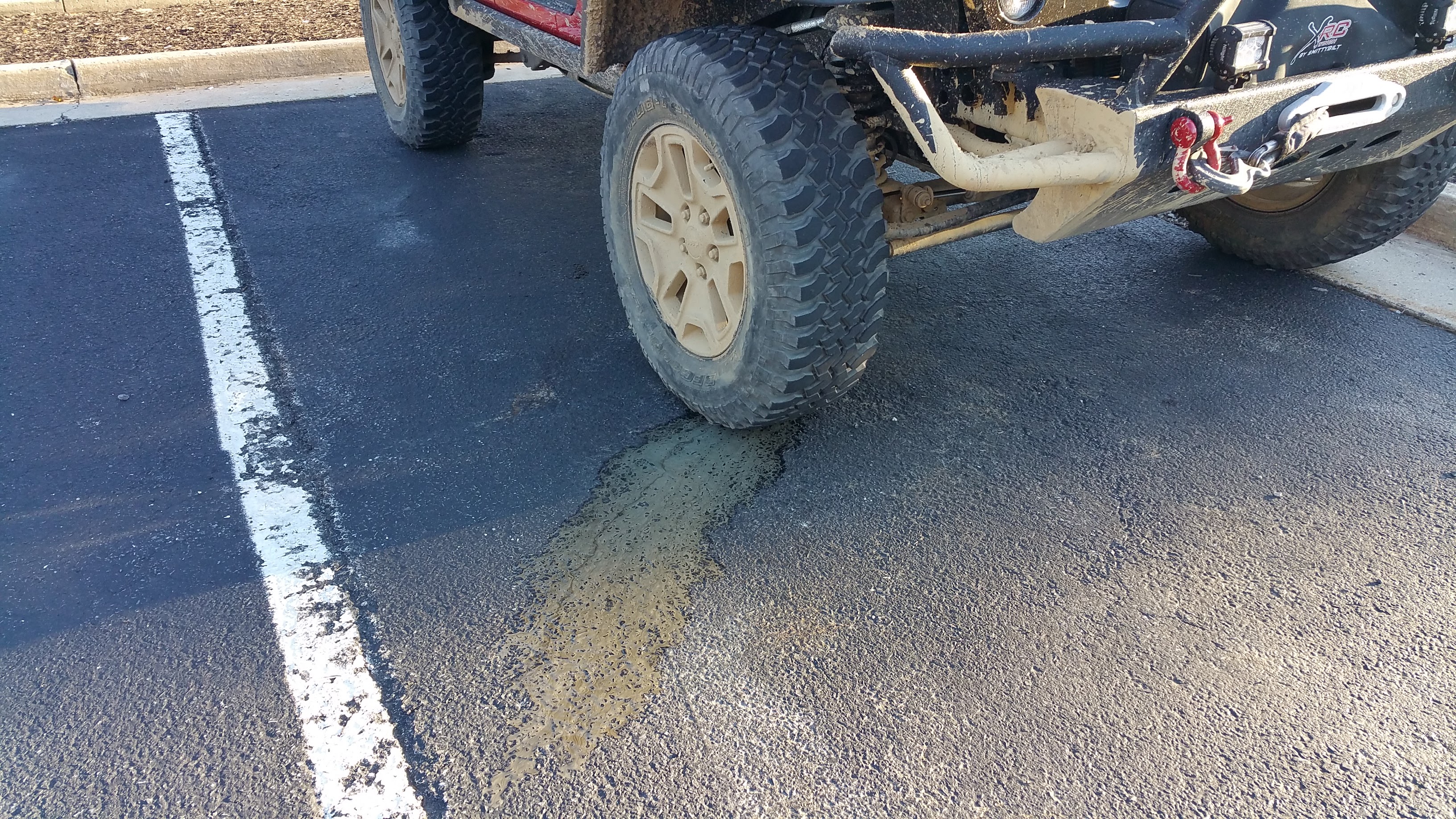

Naaa. At a fraction of a degree, you would never know or notice it. Like I said, I'd gusset it and leave it be. He's bent about a gnats hair. Not worth trying to spend money on replacing good ball joints (assuming that they are good) for offset balls to chase 0.4° on the one side. If it is keeping him up at night, I guess... do it. But that's not something that should bother you as long as your getting the gussets welded in to stop it where it is. If the grease seals start leaking and you pull them out and see that one part of the rubber seal is worn to nothing and the opposite side looks like new, you know that the tube is bent. Time to order a new complete axle.
If bent enough, first you get this:

Then you find its from here:
