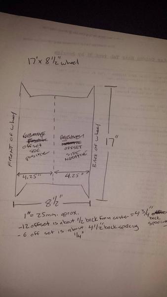

I believe this is the way it was explained to me, kinda sloppy but hope you get the idea. please correct me if im wrong about this

Originally Posted by JKRescue08
+18 is more than 5.5" backspace and -12 is more in line with what others usually run and standard that wont rub on the Jk - approx 4.5" backspace. Go with -12 offset.
Forgot to mention, I will not be running the spacers with the new wheels..does that matter? They stick out just a little bit now with the stock wheels and 1.5" spacers...not bad at all.
Old Mar 26, 2014 | 01:48 AM
nthinuf's Avatar
Posts: 11,463
Likes: 165
Originally Posted by iflyhi22002
I like how right now the tire sticks out just past the wheel well, but not too far.
It seems like most people go with the -12...any input would be appreciated.
There is information in both of the threads stuck to the top of this modified area. One of them indicates that the stock rims have a 6.25" backspace. And your spacers are 1.5", correct?
6.25 - 1.50 = 4.75", right?
So if you like where your tires are sitting now, a 4.75" backspace is what you want on the new rims. If you decide that you want the tires tucked in a bit further, go for a 5.00 backspace. A little further out, go for a 4.50 backspace. If you think you will move to taller/wider tires in the future, a lower backspace will be much better than a higher backspace. Not a lot of rocket science here.
