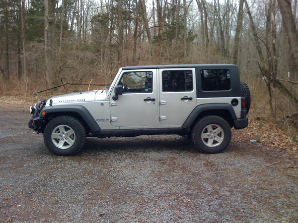

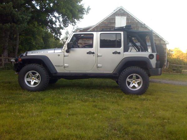

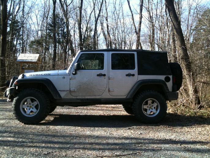

Here's a pic of the different coils to give you an idea:
stock:
616/617 coils with stock rubi tires:
618/619 coils with 35" BFG KM2s:
+40's gave me a little more room to stretch the 35s and obviously a little more ground clearance. I'd also strongly suggest getting some adjustable control arms with the kit to really tighten up the flightiness. And if you're going to add a heavier bumper/winch I'd strongly suggest putting the spacers in (& the front bumpstops) the first time and save yourself some hassle. BTW TF rear spacers are nice on with the lower coil retainers in Northridge's kit since they have coil guides.
stock:
