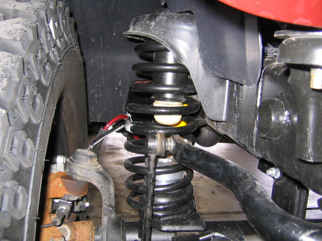

Just a quick question:
Can you provide some pictures of your passenger side spring, with the jeep just parks flat on the ground(not flexing)
BTW Jeep looks great.
I didnt know if you meant front or rear until I took the picture. Guessing you are wondering if everyone gets that bow... Looks like thats what OME is selling... Have to admit that is a bit disappointing. Not sure if I would go OME if I were to do it over again.

Thanks! so much for that picture
Yeah. That is not good. I feel like an ass kind of now. I have been pretty hard on the place that installed mine, but its not all my fault..
ARB said it was not normal to have that bow....... I sent pictures, etc......
The conclusion with the new set of springs in there is ............. now both sides are bowed instead of just the pass side
If I would have known the kit had a bow I probably would not have lifted
