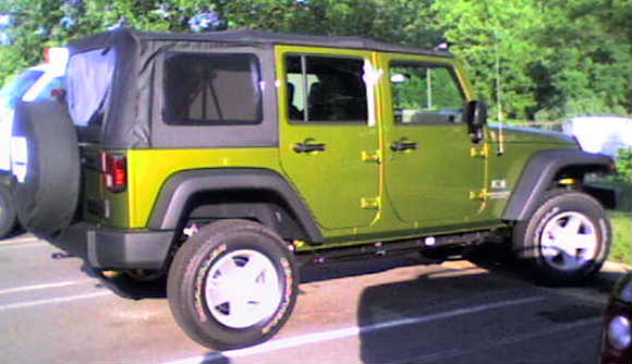

Talk to Dave at Northridge 4x4...see sponsors list..he is very good on the OME.
I don't do much wheeling, just have to cross a big da... river once in a while...with the HD setup with the trackbars has my jeep running great.
here is pic of it lifted with stock shoes...really sucks..I have 5 new wheels in storage and waiting to get the cash for BFG KM2s Then she'll look decent.
