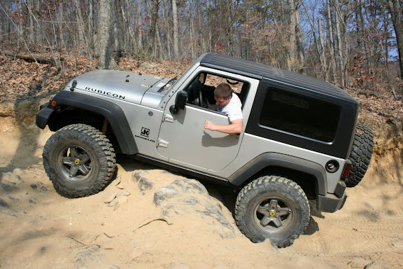

You definately want to go with the HD springs. Mine had a 3+" net all the way to the trail. After flexing it pretty hard all day long they settled quite a bit. So much so that I had to re-allign the steering wheel. I would say that you will net somewhere in the 2.5" range with your setup at most.

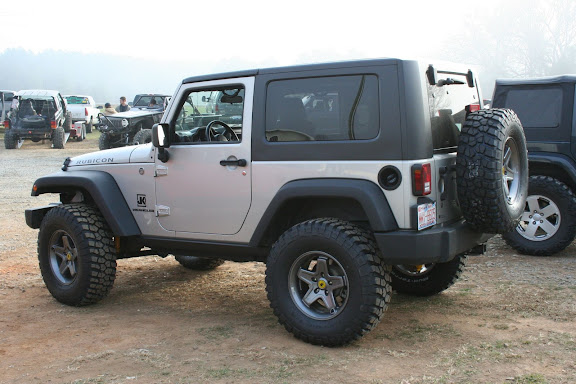

Go 35s and never look back...you wont regret it.
6speed = you can live with 4.10 gears
auto = definately regear
mpg = it WILL get worse
