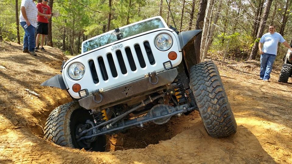

It has been awhile since I have checked this thread. The reason why I went with the light/medium coils is because I am not adding 100lbs worth of bumpers to the front and rear of my jeep. I have the springs and shocks installed now. I also installed a RK front adjustable trackbar and front lower control arms. I need to crawl under it and measure how much lift I gained overall. My next step is to fully flex it out and let it droop to see if longer brake lines are needed. On the road it handles great. I have wheeled it but when I do I have to leave my swaybar connected as it rubs pretty bad. My front flares have been chopped and I still need to do the rear. Longer bumpstops are on the way also.
