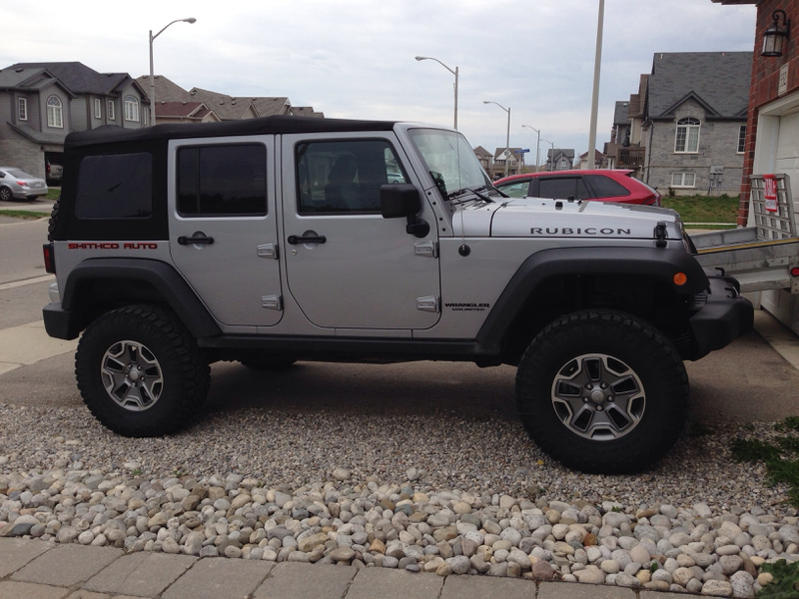

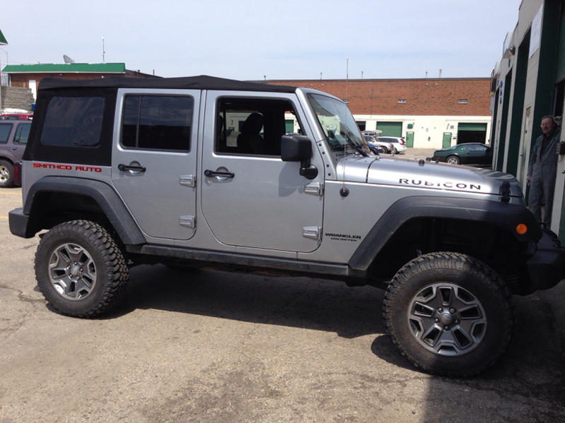

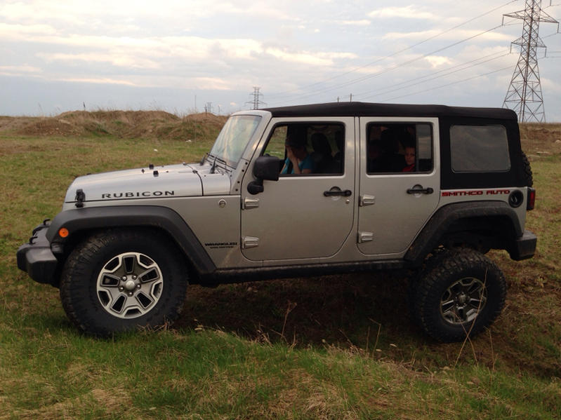

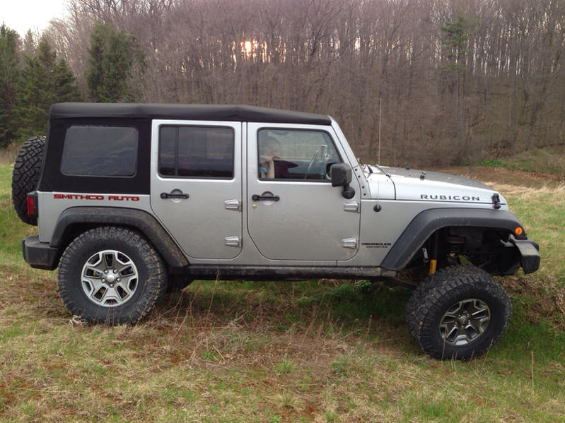

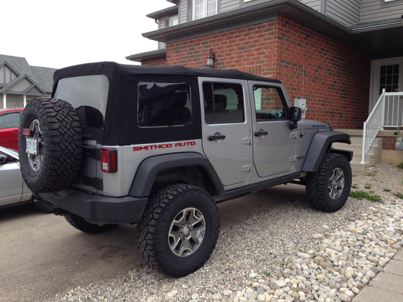

I take it no one does, so I will make the plunge! Bought the ome 4" lift kit. And this is how it sits from stock, to lift with stock tires, to lift with duratrac 315/70R17s
Any questions about the lift install, please feel free to ask. All I can say is that I have put on a lot of different kits on these jk's and the quality of this kit is fantastic and rides great! 👍

Looks goods. How much lift did you get?
Old May 10, 2014 | 03:59 AM
mechano's Avatar
Posts: 226
From: kitchener
Thanks !
I used the 10 mm spacers up frt, didn't use em on the rear and it netted me 4.5" frt, and 4" rear exactly on the nose.

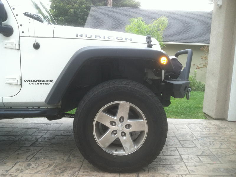

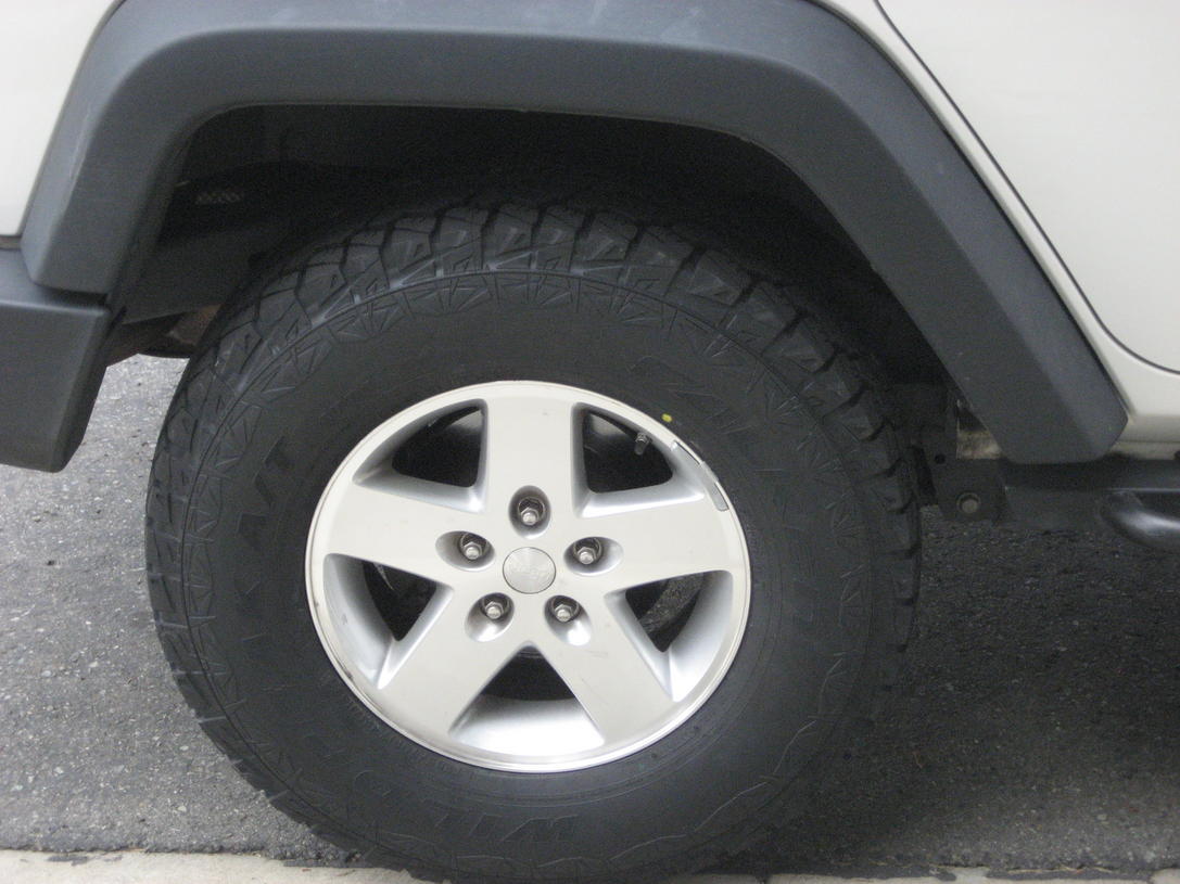

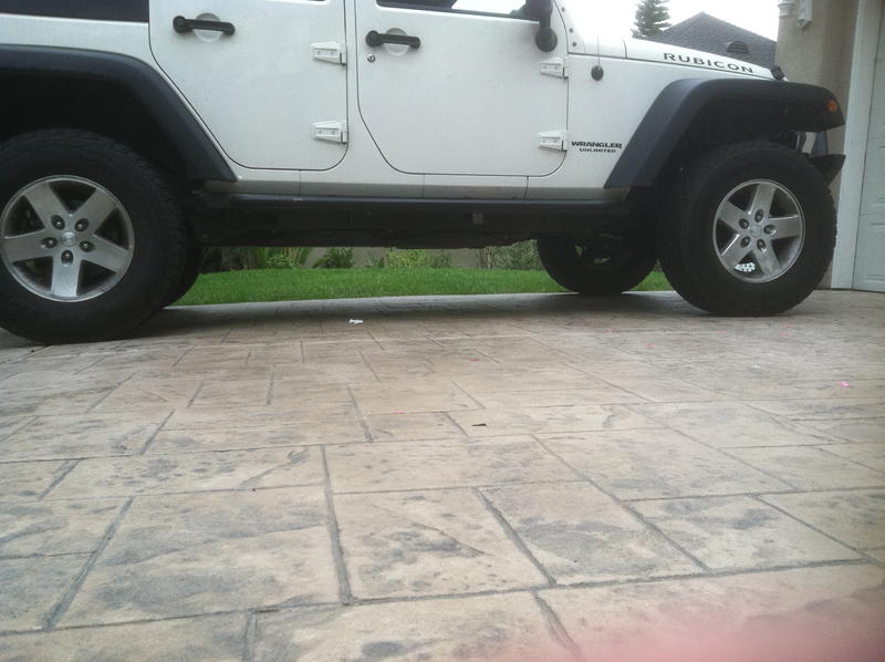

Default I have it
with my front bumper and winch the stock springs were 1/2inch up from the bumpstops so I went with Ome 4.5 heavy duty i will say they have settled a bit an i would like to add the 10m spacers those are before and after shots
