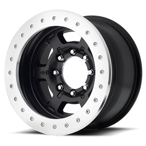

Have you considered the ATX Chamber Pro II? They're 34lbs and come in either machined or coated (black).
If you shop around they can be found for around $340 ea. I've never run them, but they seem pretty sweet.
